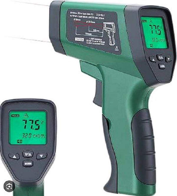

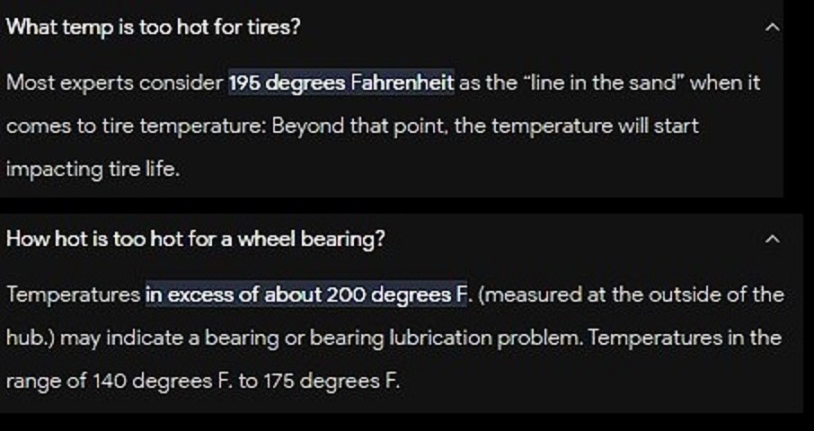

  • 1) How old are your tires? how recently have the wheel bearings been greased? do you have an infrared temperature gun to measure the temp of your tires and wheels?
    If you're planning long sustained speeds on hot highways (especially thru West Texas, New Mexico, Arizona, and eastern California (i.e., the hot southern route), then you'll need tires & wheel bearings in good shape, and check your temperatures along the way.
    tire & wheel bearing temp monitoring.jpg (79.18 KiB) Viewed 7576 times
    temperature guns can be bought at big box stores or Amazon, at prices from $8-$300
    infrared temperature gun.JPG (66.54 KiB) Viewed 7576 times
    I carry my Greenlee temp gun in my tow vehicle for camping (or in any of my vehicles, on long trips, especially in summer), and check temps whenever I stop (sometimes just for checking the temps). I've done that for nearly thirty years (or at least as long as I've had that device), and I found and fixed a dragging trailer brake (on my race car trailer) before it caused a heat problem with the bearing. They're worth the cost just for finding a heat problem, and I've used mine for engine & cooling system diagnostics, too.

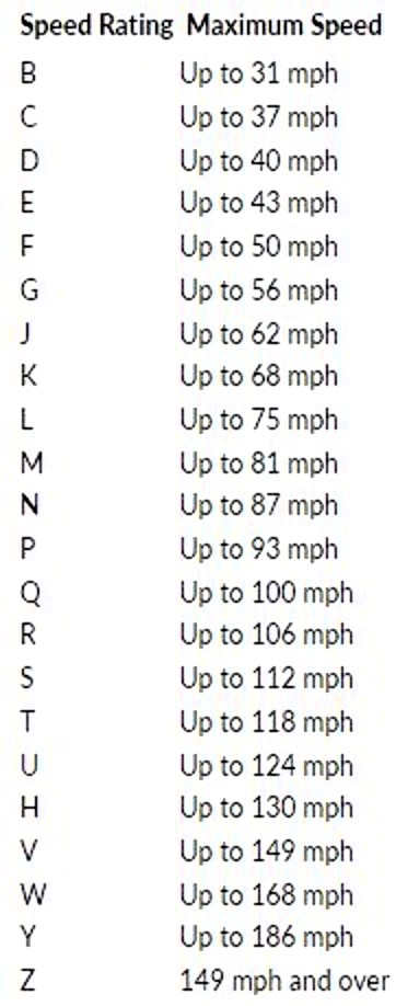

  • 2) You're confusing the "C" tire load rating with the speed rating, when you say the internet states 37 mph for your tires. You also have said that your tire has a "M" speed rating, which is actually 81 mph.
    tire speed ratings from Discount Tire.JPG (64.72 KiB) Viewed 7576 times
    Texas highway speed limits are most commonly 70 or 75 mph, but some stretches of I-20 in West Texas are 80 mph, and there's one one stretch in Central Texas that's posted as 85 mph: "Texas 130 between Texas 45 near Austin and Interstate 10 in Seguin has a posted speed limit of 85 miles per hour." You'll find that most drivers go a bit faster, but I'm usually towing at 72-75 (depending on traffic) because my '04 Chevy 2500HD tow vehicle likes that speed range best. Since it doesn't notice my squareback trailer behind it, my gas mileage doesn't increase much, no matter what. YMMV

Postby working on it » Wed Mar 20, 2024 10:23 am
Bikeneggs wrote:...Don't know anything about an "M" rating on the tires. Originals were B rated and the upgrades are C rated. Will bring both originals along as spares, hoping to mount them underneath the floor between the chassis spars closest to the axle.
"Sorry about that, Chief" (do any of you...other than us old guys... remember where that quote is from?), I guess I mixed up my research when posting that. I had four or five TnTTT threads open, plus another four or five other websites, too, so I got my reference wrong attributing the "M" tire rating to you, Bikeneggs. Otherwise, every other item in that post is correct.
