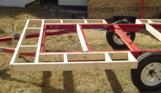

I am thinking about adding 6" of width on each side (no length) of my NT trailer using lumber, sort of as seen below but with the wood level with the side rails. Build the additions (4), paint them and bolt them to the sides. Use moisture-protected Luaun strips or some other material over the cross members to bring them up to the level of the side rails, or add wood cross members as below. Floor ply over the top would tie it all together. Add foam insulation from underneath and screw/glue to the floor. Seems it could save 2 1/2" to 3 1/2" in height for my standy. Anyone done this or seen this method used in the past? It seems somewhat unusual for this forum.
The picture below is from a YouTube video: https://www.youtube.com/watch?v=lT8JGdkkfAU

Re: Adding width to bolt-together trailer using wood
Postby EZ » Mon Feb 12, 2018 1:52 pm
Found this picture on the forum somewhere..... Looks like I am not the only loony thinking of this. :R
Postby EZ » Wed Feb 14, 2018 9:13 am
KennethW, that is not my picture above with what looks possibly like treated wood. I am considering just some 2 X 4 material on the sides only to extend out 8". More like what the top photo suggests (also not my picture). I can see that as resulting in saving maybe 2 -3" in the height. If I flip the axle that might save another 2 1/2 inches. For a standy on a trailer that has like a 20" high deck that is a lot.
