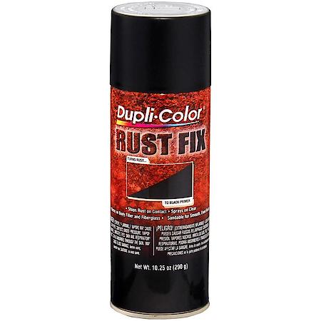

I have sanded or wire brushed trailer frames down to bare metal. I then clean it with acetone. I then use Duplicolor. From the manufacturer - Dupli-Color Rust Fix destroys rust on contact by bonding and transforming it into a sandable and paintable surface. Sprays on clear and transforms into a black, metal protecting coating that prevents future rust from forming. Rust Fix saves you the time of sanding all the way down to bare metal and can be used with body filler and fiberglass. Keep us posted on your progress
