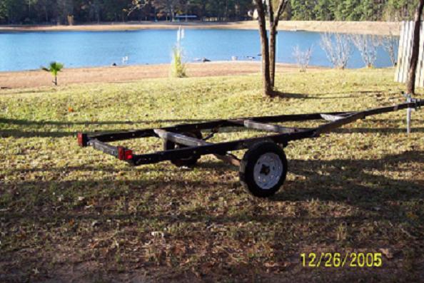

Postby angib » Sat Feb 11, 2006 6:31 am
Top Tip: Get a boat trailer with flat frames like the one Steve/Sonetpro has pictured. Many have "vee" frames, and they would have you and your partner rolling into each other all night..... :lol:

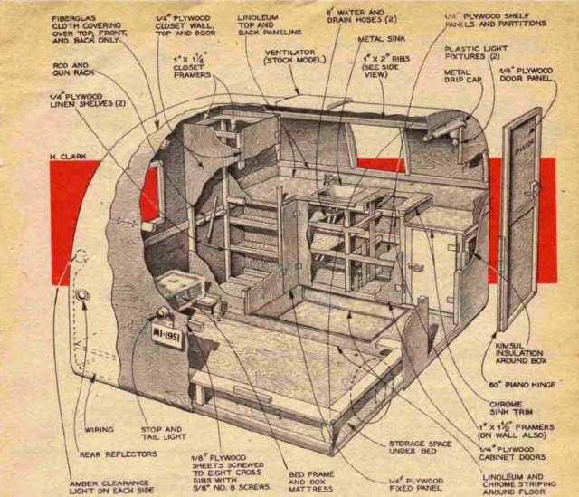

Postby mikeschn » Sun Feb 12, 2006 6:30 pm
Build what is right for you...
Here's a tiny travel trailer that could be build on a wider trailer...
Postby GPW » Mon Feb 13, 2006 9:00 am
That's a cute idea, but with all that stuff up front , what about the tongue weight ??? Could be reversed, that'd work !!!
