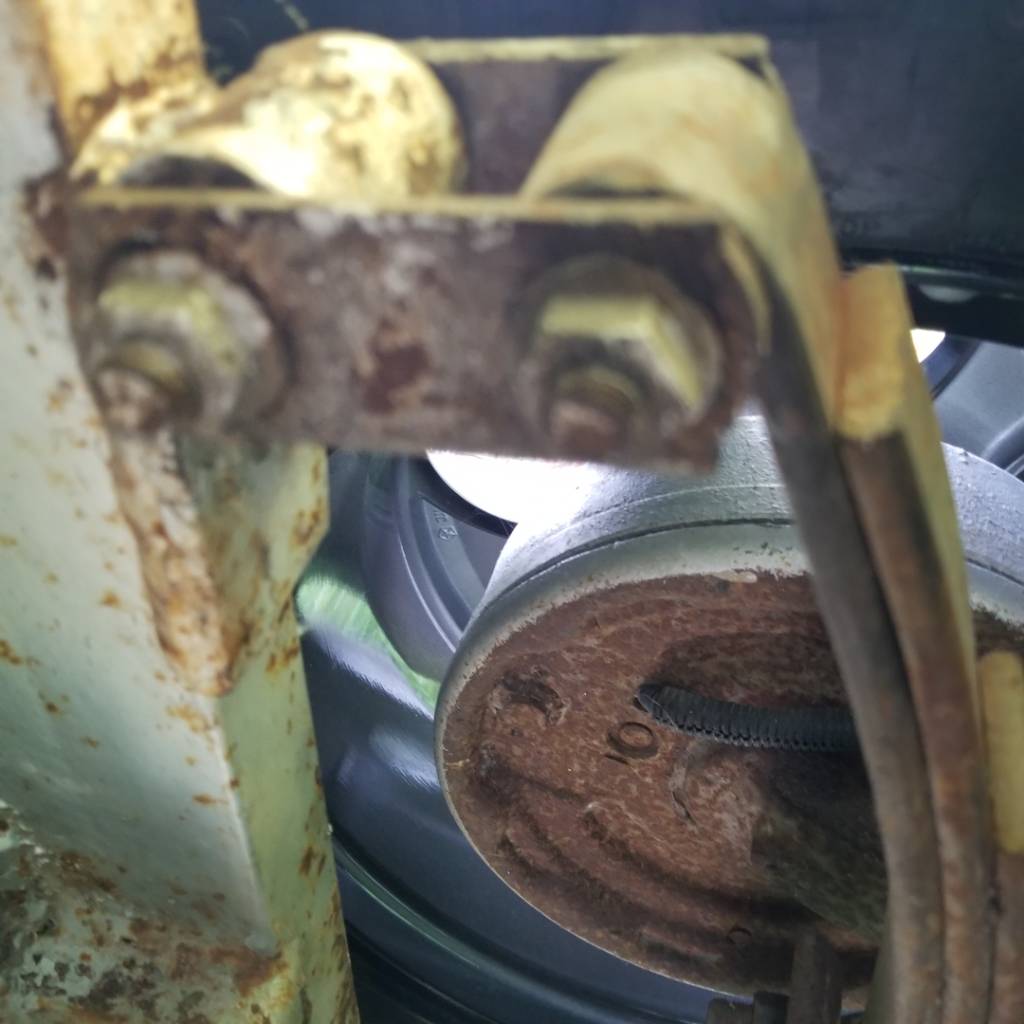

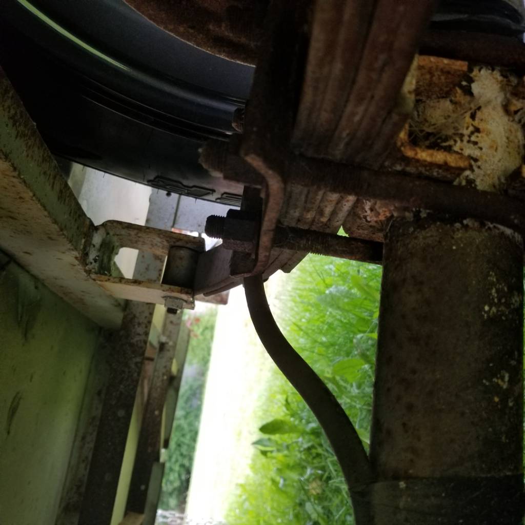

Here a few, not great, sorry. The wheel wells have to be modified. This is trailer #2. I've attached a photo of trailer #1. We are renovating #2 to have queen bed in it. ImageImageImageImage

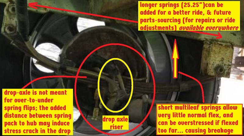

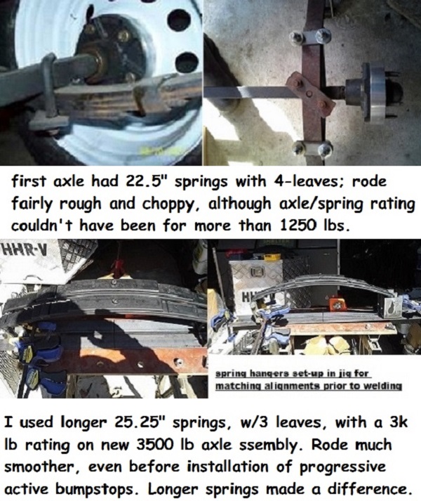

Postby working on it » Wed Aug 01, 2018 10:48 pm
QueticoBill wrote:...I think I would get as much info about total weight and look at e-trailer for the right u-bolts and plates. ...But the travel is key - how far the leaf springs will deflect....
E-TRAILER wrote:The leaf thickness, width and number of leaves has nothing to do with the capacity of the leaf spring, because the quality of steel and how it has been prepared for use as a leaf spring will affect its capacity. Some single leaf springs can carry more weight than a 5 leaf spring that seems to have 5 leafs all the same thickness as the single leaf spring.
Typical Axle Diameters Based on Axle Capacity:
1,000-lb - 2,000-lb Axles: 1-1/2inch - 1-3/4inch diameter
3,500-lb Axles: 2-3/8inch diameter - Can have a 3-1/2inch diameter, but rarely
-and, regarding LOWERING the ride height, just reverse what follows
Swapping the shackles, would not be a good idea because the hanger location would remain the same and cause the shackle links to rest at a harder angle more straight up and down which would cause a stiffer ride and would only raise the trailer on one side of the axle, cutting your probable lift in half.
The best way to raise the trailer an inch would be to replace the spring hangers with hangers that are approximately an inch deeper from the center of the bolt hole to the top of the hanger. This would require cutting off the old hangers and welding on the new ones, like you mentioned. You would then use the same length shackle links as originally used.
Another option that does not require welding is an over under spring conversion kit. This would raise the trailer the diameter of the axle plus the spring seat, so you might not be able to use this option since you only need an inch in height.
  • I don't think that trailers using drop axles can be lowered (safely), without causing stress fractures to the riser, further down along the road. And, possibly added stress to the spindles, and maybe to the spring hangers, all due to the added distance between the spring pack and the spindle center-line. I do think that you might get better results by replacing your aged-looking axle & springs (looks similar in spring size and shackle/hanger configuration to my original axle) with either a new torsion axle set-up (you said you liked Timbrens, and torsions ride similarly, over paved roads), or with a new longer leaf-springed & straight axle set-up, and eliminate the possible weaknesses I pointed out.
  • I didn't buy a torsion axle to replace my old axle, but installed a completely larger/longer/stronger leaf spring assembly, so I could trust it with my TTT's increasing weight, and to avoid any future repairs to my original set-up. I knew nothing about the specifications of what the springs were rated for, nor where to source parts for them, and also nil about the axle itself. By starting fresh, with commonly/readily available, standard trailer parts, I could "make it right" (a Canadian quote).
    suggestions for drop axle replacement.jpg (164 KiB) Viewed 2547 times
  • All the components used in my upgrade, can be found at stores everywhere, and even the custom-built Dexter axle can be re-ordered and shipped to me in a week. I couldn't find any hardware or springs similar-enough to the original, and really didn't want to stay with that set-up, when repairs were needed, so I threw out the entire thing. Plus, I got all I wanted: heavy-duty 3500 lb axle, brakes, new hangers/shackles/hardware, and especially longer/stronger, seemingly softer 3000 lb springs. Then, to save the springs from over-flexing, and for shock-absorption, I made active-progressive bumpstops, which will prevent spring breakage (I've had a couple break, on another trailer), and reduce or prevent shackle/hanger damage in any foreseeable event. Now might be the right time for you to replace your suspension, too.
  • I mentioned that the new, longer, 3000 lbs (per pair) were seemingly softer-riding than the old ones...perhaps not, because the old shackles had been over-tightened, and I'll never know how they should've felt, but I can easily get replacements (or rated for a softer ride), at any TSC, Northern Tool, and trailer supply shop anywhere, to "dial-in" my ride quality, if need be. These 25.25" eye-to-eye springs are sold everywhere, as a trailer standard size, for $25-30 apiece; replacing them would be simpler/cheaper than fixing a torsion spring ride quality problem, because they are set for life, as-ordered. I'm just saying...now's the time for a change.
    longer springs on home-built hanger assemblies.jpg (170.97 KiB) Viewed 2547 times

The axle can usually be moved from above the axle to below safely ( assuming adequate clearance). The only gotcha is that if the axle has been designed with any toe in then you could eat tires quickly. Based on the pics from the OP, I think it will be fine.
Socal Tom
Posts: 1347
Location: San Diego Ca
Re: Moving axle
Postby KCStudly » Thu Aug 02, 2018 2:31 pm
Socal Tom wrote:Based on the pics from the OP, I think it will be fine.
I'm not so sure. I think I can see a little camber in the first pic^^. If the axle has a bow up in the middle, that is factory "installed" camber and should not be flipped.
Flipping drop spindle axles is not a good idea. It will tend to put a lot more spring wrap into the springs and could cause issues with longevity (i.e. broken springs). Think about it like a plumb bob or Weeble vs. a guy on a unicycle. With the pivot point high and the attachment point low the load tends to be self righting, resulting in more stable spring loading. Torsion reactions will be aided by gravity to return to neutral. With the pivot point low and the load high, the spring, in addition to bearing the static load and vertical displacement, will see more repeated torsion reactions tending to try and keep the load neutral over the pivot point, despite gravity; just like the guy on the unicycle constantly pedaling back and forth to maintain balance.
Also, you want your brake assemblies to remain in the proper orientation so that they still function; short liner to front, with pivot point and magnet actuator in proper orientation to the ground, elsewise you will compromise braking. I know for sure that some backing plate bolt arrangements are not symmetrical, and therefore can not be flipped to correct brake assembly orientation on a flipped axle.

Looking at it on a bigger screen, he might be right, there might be a curve. To make the change you would need to have the mounting plates moved to the other side of the axle, so it didn't get flipped over if that is true. It might be an optical illusion, but if you put a straight edge on the center of the axle you can check.
