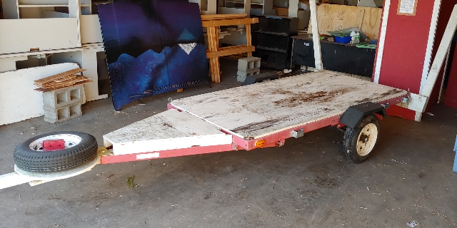

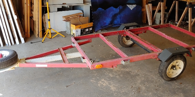

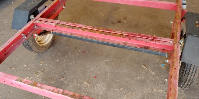

I picked up a used Harbor Freight 4' x 8' trailer to build my Chesapeake light craft trailer kit on. I haven't ordered the kit yet as I'm still saving up my dollars but the trailer needs some TLC. There's some light rust on it and I am disassembling it (not before taking numerous pictures) and want to reassemble it without using the folding option. Although I don't have the manual yet for the Chesapeake light craft kit, I'm assuming it's like all the other Teardrop trailer Builder instructions where they recommend not assembling the Harbor Freight trailer using the folding option.
The problem is, I don't remember how to do that. I have the manual for the Harbor Freight trailer and it does not show how to omit the folding option. I'm sure it's nothing too difficult but does anyone have any suggestions?

IIRC, I drilled holes through the spring C channel and rear rails and bolted them together. Make the floor one piece.

Take out the 2 cross members and bolt them across the seam. Then just get a piece of angle iron and replace the 2 you took out. The cross members and the side channel are rolled channel, so they have a small radius in the corners. They fit in great.
