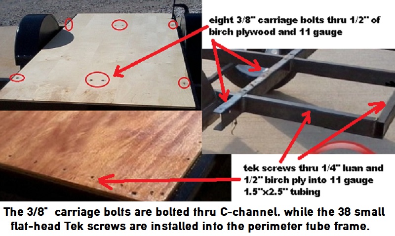

I'm ready to mount the (mostly completed) body of my trailer. My body has a plywood floor and the frame is 2X2" 1/8" wall steel tube. Best to use u-bolts, weld on brackets, or drill right thru frame? Or something else that hasn't occurred to me :thinking:

  • I bolted/screwed my plywood floor to the metal frame, in two stages. I used PL Premium adhesive to seal between frame and floor, then sealed any open spaces from underneath, with spray-on (rattle-can) undercoating (goes on dry, absorbed by the wood). http://www.tnttt.com/viewtopic.php?f=35&t=68349&hilit=+tek#p1202710
    carriage bolts and tek screws.jpg (131.65 KiB) Viewed 1824 times
