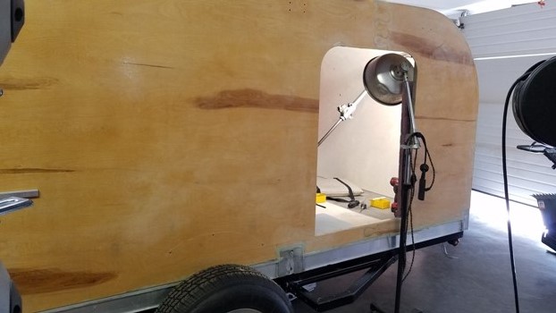

pic of mine because

I looked quickly and didn't find a picture of the front but here is what i did, my intent is sliders if they hit, (Not Me) we continue on. City bumpers
