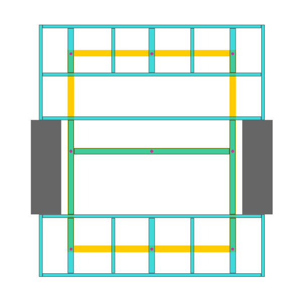

Postby MickinOz » Mon Jan 11, 2021 5:35 am
My thoughts:
Having weighed the pros and cons, I'd go with option 1 - framed and clad with 1/8 ply, since you have the materials already.
Fasteners in the floor ain't a problem.
I'd have the 2 x 1 on edge so that the long face is vertical.
I'd have the perimeter frame, and three internal cross members, so the ply is only spanning around 15 inches centre to centre.
Then glue and staple. This won't weaken anything.
The resulting torsion box is going to be remarkably strong and resistant to twisting.
I'd consider two layers of 1/8 ply on the floor top surface.
I just think 1/8 ply would probably be easily punctured by localised point loads.
There is a bit of a problem with the plan though.
You are planning to overhang the trailer frame by 6 inches fore and aft, 4 inches on each side if I have read your post correctly.
If you were to build the common floor frame then across one way, there are three cross members adding strength. The other way there would nothing to prevent flexing. Bit of an issue I think.
I think that I would do something like this for the internal frame of the floor.
Not to scale of course and its only a first draft, but if you want to build a light hollow cored floor, then there should be solid wood framing crossing the trailer frame all the way around, I think.

Light but strong.JPG (36.87 KiB) Viewed 1728 times

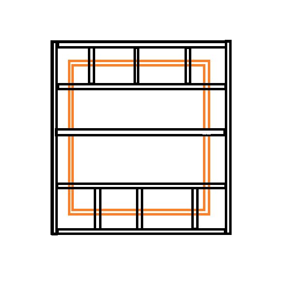

Postby rccoulter » Mon Jan 11, 2021 2:16 pm
MickinOz:
I was thinking along those same lines. But without putting the 1x2s on edge. If I do that I'll just have to add some 2x2s for where I'm bolting it to the frame (see attached image).
I've got to admit, I think I might be talking myself out of the sandwich floor the more I look at the design. Looks plenty sturdy, but it sure is a lot of work to save 5 or so pounds (~44lbs vs. 50lbs). When I was thinking of laying the 1x2s on their side, with only one layer of 1/8" on top, the weight savings was almost half (~26.5lbs vs. 50lbs), but I can definitely see where that wouldn't be strong enough, especially with the overhang.
I can still save quite a bit of weight doing the sides as a torsion box though.
Thanks for the input. That was really helpful.
