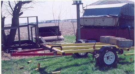

My welder sets in my shop but I got a great deal on the Northern tool frame shown so I just modified with a $9.95 Harbor freight 4 1/2 grinder and a few cutting wheels. I decided a trailer with a title made it easier to get plates than a police inspection and the hoops needed to get certified from a frame down build. Don't forget the axle and tire costs when planning.... Here was my first frame , part heavy duty hand rail and part harbor freight tongue and axle assembly ( total cost $75.00 at this point in time) a cobbled up mess of welding that has survived 11 years and thousands of miles and dozens and dozens of outings....
