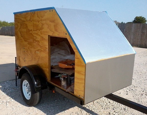

* I also went with 25%, 50%, 75%, and 100%, but did two coats at each percentage, but with a difference in drying time. Since I was building mine at another location, and had to do it when I could fit it in between other projects at that location (50 miles from home, on weekends only, often being unable to work on it at all), I did my "mix" and Poly coatings in full sun, and between 106 and 110 degrees in one afternoon.
* As you might guess, each coat dried fast (flashing over within minutes), so I completed the eight applications in just a few hours. Then, I rolled it back into the shop, where it cured for a week, before I painted over the poly with two coats of acrylic enamel (two types, in different spots: grey tractor paint on lower front and sides, reflective/aluminized silo paint on top front, roof, and rear hatch). Again, it was in full sun and 100-110 degrees. The black Rustoleum edging paint, several layers over exposed plywood grain (already thoroughly polyurethaned), was applied a week later, this time in the shop.
starting the grey and silver topcoats.jpg (105.89 KiB) Viewed 1169 times
* I re-covered the silo paint a year later, at home in my garage, to smooth out some brush marks (and contact dings on the hatch), but otherwise the "mix", poly, paint has been good for all this time, perhaps due to being in my garage 99% of the time since 2012. I never had to resort to covering it all with bedliner as I had planned, in case the paint failed or separated from the poly undercoats. No sanding was done prior to painting, nor between coats, just wiping the dry surface with thinner, first, on the plywood from Home Depot (it was listed as pre-sanded ACX).
