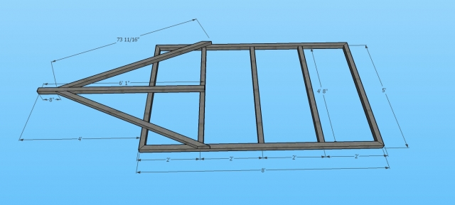

Hello! I bought Tony Latham's book, and am getting ready to weld together a 5 X 8 skeleton for our tiny trailer build.
I am going to use 2 X 2 X 1\8" metal for the frame. I am going to adjust the diagram for the shorter length.
I plan on using mitered corners for the 5 X 8 platform, creating a closed box.
I have two questions:
1) What is the best way to close the three holes at the rear of the 2 X 2, that attach to the tongue?
2) How do you figure the angle to cut the two pieces that join to the tongue? And what did you use to cut them with?

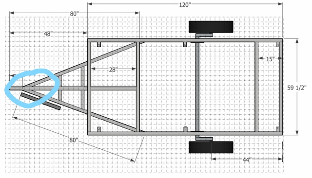

I cut the A-frame tongue pieces (at the rear) at 90º and plugged with plastic.
For the front, I put them under the 90º piece, marked them, and then cut with an angle grinder using a cut-off wheel.
If the angle would help, I can probably pull up Sketchup and figure it out for you.

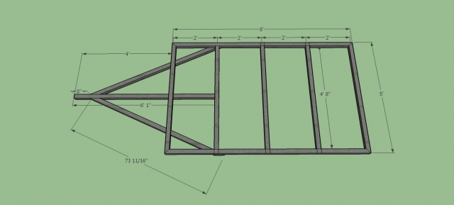

I have been working with Sketchup Make:
I will figure out where the axle goes tomorrow...

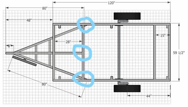

as for the angle ... this aint rocket surgery and the angle doesn't have to be specific
as in yout drawings lay out your pieces on top of one another and w/ a piece of thin posterboard under them simply trace your angle for transfer to the metal parts
this angle will be the same for all 4 cuts
just make sure the resulting lengths of the 2 diagonal braces are the same and that they come out in the same places on the sides of the tongue and body
no one butt you know where you wanted them and and a chigger whisker's difference between your drawing and the finished product will never be known nor will it matter structurally
if you are unsure of capping the aft ends of the diagonal braces cut an oversized piece of plate and extend the cap up the side of the frame a hair for added strength at that point
one thing i have done where the braces meet the fwd end of the tongue is to cut n weld a decorative gusset(arrow head shape) on top of that junction which can hide a lot of err...
