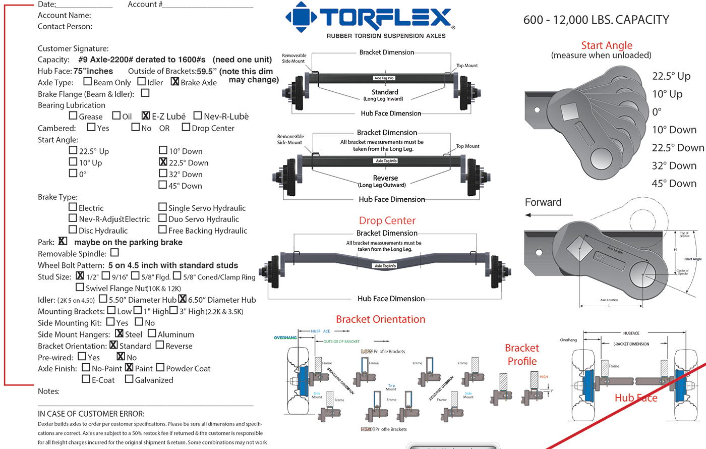

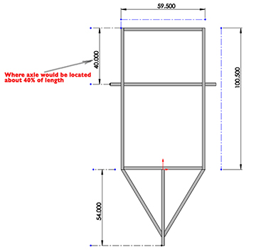

Before I submit this to Dexter, I'd like to ask if anyone would help by reviewing this and making sure I've got all this figured correctly.
The chassis frame of my trailer will be made from 2x2 x 1/8" stock.... be 100 inches long and 59.5 inches wide for a 5 x10 trailer.
2 images attached.... of the trailer frame (which I don't have all the supporting members drawn in yet)... and the Dexter Torflex order form.
The 2 things I'm unsure of are the 2 brackets orientation and positioning (do they get welded to bottom of frame?) and the hub face dimension. I'd like to have about 2 inches
between the tires and the trailer housing. Hopefully that is "good".
Thank you very much for any feedback. Appreciate your help!!
John

That should be fine.
Make sure you install the axle using the axle stubs, not the cross-member as your 60/40. point.
The axle will come with the brackets bolted to it. You just tack the brackets in place, remove the axle, and have at it. But weld no more than about 3/4" and then stop and let it cool down or you'll warp the frame. :frightened:

Postby Capebuild » Sat Feb 20, 2021 12:26 pm
thanks for all the feedback. I definitely intend to get brakes... I was questioning whether a "parking brake" was needed/ necessary??
Thanks for the comments about the EZ lube.... I'd still consider that option, but would also do a typical maintenance, as well.
One other issue I'm trying to get my head around is the hub face dimension, as I have a feeling that's going to determine how much space (clearance) is
left between the tire and trailer cabin. I'm thinking 1.5 inches (on each side) is probably sufficient (any thoughts on that?)
Thanks for all the help, I appreciate it!!
