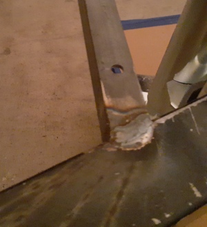

My box rests on the A frame but I welded Angle Iron front and rear of the box and drilled 4 holes through the box & angle;
Won't have un threadable bolt, nuts.
Angle Iron.jpg (39.64 KiB) Viewed 698 times
