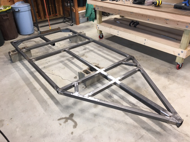

I'm just about finished welding up the frame. The unit feels awfully heavy to me. I stood at a point where the frame was balanced and the frame standing upright on one of it's long sides, so it was balanced. I could lift it, but not easily. Maybe I could lift 200 pounds. But was just wondering if anyone had an idea of what a chassis for a 5x10' trailer should weigh? I used 2x2" with a .125 wall thickness. This might be an unanswerable question.... but thought I'd ask :) (the frame does not have the axle installed yet....so just the frame).

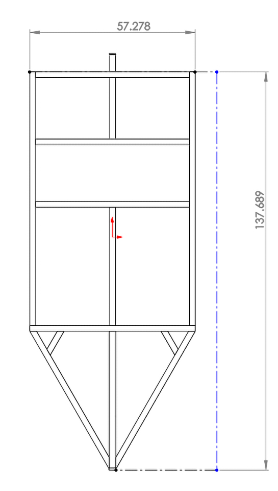

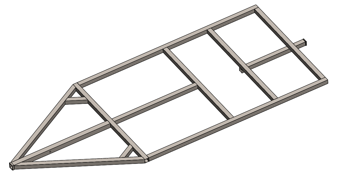

When I did the CAD I'm able to assign materials and mass weight to the material. I did assign 3.45 pounds for a lineal foot of the 2x2 tubing: which is mostly what was used.
The front tongue receiver and rear receiver have .250 walls, so they are a bit heavier, per lineal foot wise. But when I calculate it all up (what is shown in the attached image)
I get 170 lbs.. It may well be around that when I lift it. Tomorrow I'm going to get on a bathroom scale and try and lift it a little just to see if I can get a reading (subtracting my weight).
Thanks both for the follow up though. Quantico Bill, that is a good idea to add up all the lineal footage and apply the 3.05lbs per lineal foot (that is also the weight the supplier stated in their literature for the 2x2" .125 wall tubing). I hadn't thought of that method.
Not including the front and rear receivers I count up about 48 feet. That would be 146.4 lbs. So if I add in the front receiver which is 29 pounds and the rear receiver, call it 15 lbs
(I cut it and don't know the weight prior to cutting it), That brings it in at 190 pounds. I still have to add the tabs to attach the cabin, but that shouldn't add too much more weights.

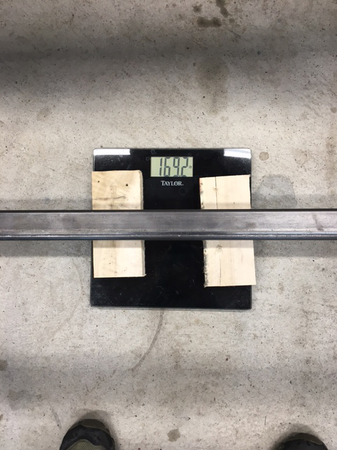

John, when I was weighing heavy parts I put two short 2x4s on the scale (like foot prints). Then place the object on those so I wouldn't have to lift awkwardly (and unsafely). Give it a try. Sure beats pulling a muscle trying to balance you and 170+ lbs on the scale. A helper can read the scale or steady the object.

Great idea, Tim. Thanks for that. Yes, sounds much easier than my original plan.
Once I get to it I'll report back, but that method will definitely save my back.

WELL... I AM ONE HAPPY CAMPER!!!
First off, Tim, I have to thank you again for that great suggestion on weighing the frame. It worked perfectly.
The weight came in at just shy of 170 lbs. (see attached). Also, Quentico Bill's suggestion of adding up the lineal feet
and applying the material weights worked great in getting a good estimate, and my calculations in the CAD were also
fairly close. I was just hoping the frame wasn't going to come in a like 250 pounds or more, which is kind of what I first thought.
Also, it goes to show I'm probably not as strong as I thought I might be, thinking I could even lift 200#s :lol:
