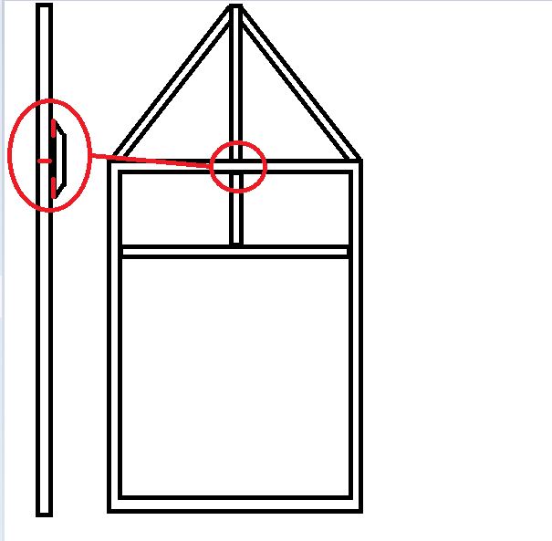

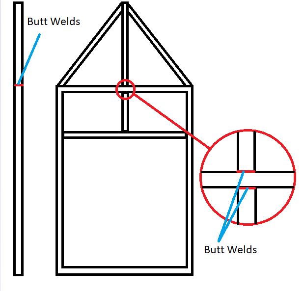

It seems a lot of guys who build their own frames just butt weld the drawbar a-frame to the front face of the front cross member of their rectangular main chassis.
If they put a centre longitudinal piece in, this often gets welded to the front of the chassis, too.
Butted on A frame.JPG (48.02 KiB) Viewed 1491 times
This isn't the strongest of methods, in my view. The A-frame will always be exerting some twisting force on the front cross member and trying to tear the butt welds.
My a-frame is somewhat like this and it bugs me a bit.

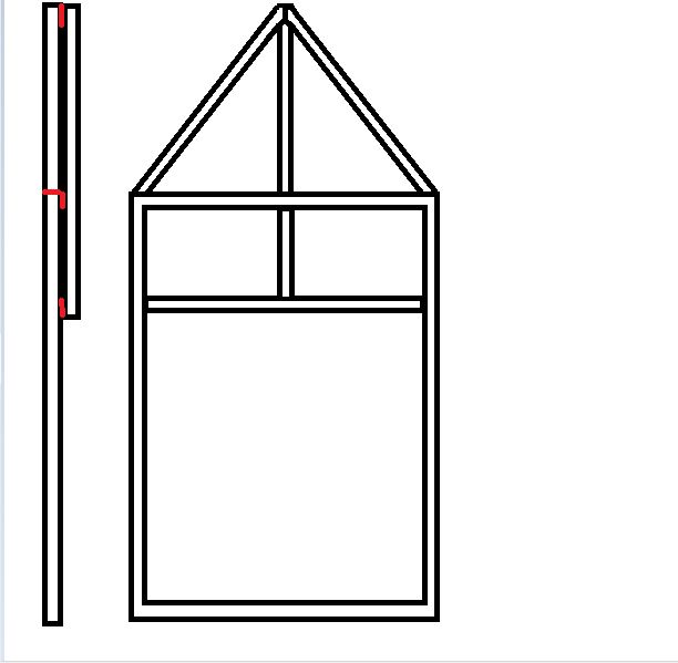

But I think the thing is best built with the rectangular main frame, a-frame out the front and that centre longitudinal drawbar passing under the lot.
Centre brace passes under frame.JPG (37.29 KiB) Viewed 1491 times
Or just do it a la NT and HF trailers, but welded from decent size material rather than bolted together aluminium foil.
If you look at Tony Latham's plan, the whole lot passes under the main frame. Much better distribution of the forces at play, I think.

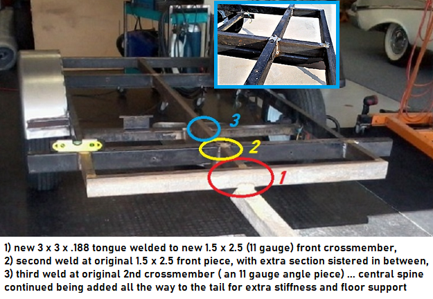

Postby working on it » Fri Jun 18, 2021 3:05 pm
saywhatthat wrote:...What suspension do you put under yours? torsion axle . ON the hard core trailer we use springs and beam axle .That way if something breaks can get fixed easily ....
* Agreed heartily with that! OVERBUILDING is better/safer/more reliable than trying to save weight here and there (on the frame, running gear, and cabin construction), de-rating torsion springs to achieve a marginally softer ride (of the un-occupied teardrop/squaredrop trailer, and later finding out that they've weakened over time, and must be replaced...maybe in the boonies). Time-tested spring axles are the easiest to customize, repair, or replace...anywhere.
* I made my squaredrop from a single drawbar-type motorcycle trailer, adding rectangular steel tubing to extend its' length to 8'. I replaced the bent original tongue with 6' of 3" square tube, .188 thick (plenty of strength for highway use), and to prepare it for off-road use (if ever), sisterred-in rectangular tubing full-length to the rear of the trailer, above the tongue (which was also joined to three crossmembers, for extra strength).
3 crossmember tie-ins, plus sistered sections.PNG (397.2 KiB) Viewed 1324 times
* And later, when changing the original light-duty axle to a 3500 lb braked axle (with 3000 lb springs), I reinforced the frame rails with 1/4" x 2" angle steel. Maybe overkill, but it will last. I stayed with the single-beam tongue, considered welding side pieces to make it an A-frame if I really went off-road, but never did. The side pieces (as seen in my signature's lead photo) are thin steel angle stock bolted on, that just serve to stabilize the sliding tongue box platform. The single-beam is good enough for soft-roading.
