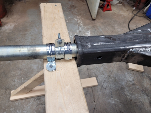

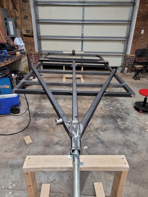

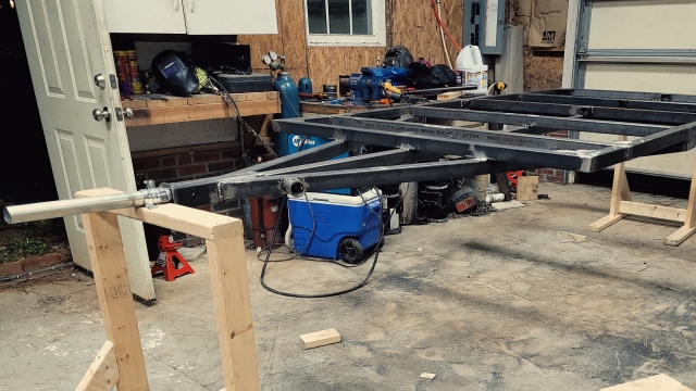

Like most, I work by myself and needed to figure out how to flip over the frame to weld, clean, and paint. Made this rotisserie for less than $30. it works amazing! I don't even need a pin. Just flip with nearly one hand and it stays in place. Hope this idea helps somebody else.ImageImageImage

Great idea ! Have fun with the building process, it's a big part of the fun.

Nice! Now that I finally have my donor trailer 'on premises' I'll hopefully be able to get started this winter and I actually have a great deal of scrap lumber leftover from building a new garage two summers ago. There will likely be many days I will need to work alone so this is a great idea.

Brilliant use of scrap lumber...
