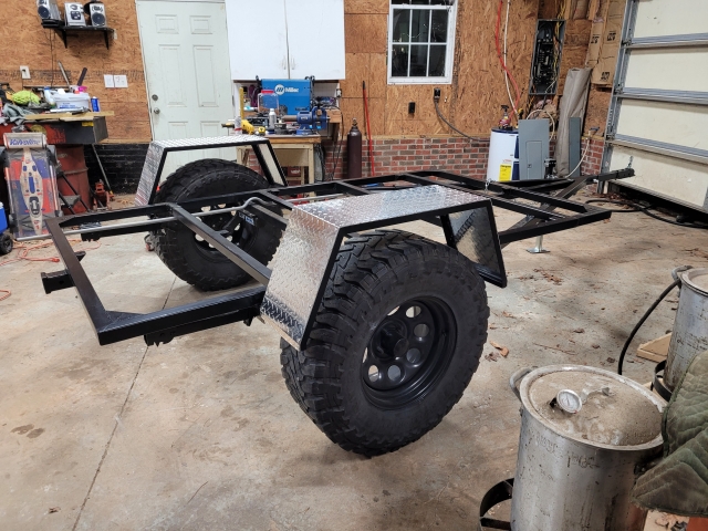

I am here to show how great this place is. A few months ago not only did I not know a thing about trailer frames, I never welded a thing. Here I am now, know a bit about trailers, and a good enough welder to get the job done. Thanks to you all! Now onto something a lot more in my wheelhouse, building with wood. (5x9, 35" tires, ~580lbs)

Looks really good. I know the feeling of not having welded and then you learn how to.....and make something useful. A good feeling. Nice job!
One (humble) suggestion. If possible, you may want to extend the rear hitch receiver to the next cross member. Maybe you have your reason for making it the way it is.
Looks like the Millermatic 211 in the background there. That's the welder I had purchased and learned on. Nice machine.

Thanks John. Good suggestion on the rear hitch but I only put it on to put the trailer on the rotisserie which may have been the smartest thing I did for the frame build.

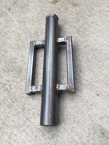

I did a few little projects before the trailer. I made a welder cart first. Then I made a steel post driver out of a bit of scrap pipe. I figured if the post driver did not fall apart, my welds were pretty good. It is subjected to a lot of stress when you pound into hard ground.

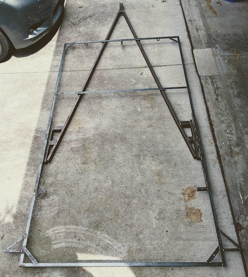

I used ideas from https://www.tnttt.com/viewtopic.php?t=51991#p956707 to design my chassis. Since it was going to be light I chose 1 X 2 in tubes for the A frame portion.
Andrew's charts indicate it should be fine. The axle was bolted to a short piece of 2 in square tubing. The outer rectangular portion is 1 in angle. 1/8 in metal throughout. The finished trailer is 510 lb empty.
The whole project was pretty slow for me but we got it on the road this past Fall and had a nice first trip.
