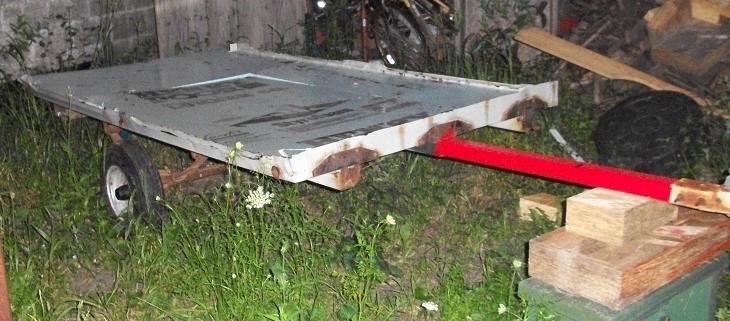

Postby bobhenry » Fri Feb 11, 2022 7:06 am
This is rip van winkles frame. It was setting in an alley and I went up and knocked. The elderly lady told me it was her husbands little trash trailer before he died. We settled on $60.00 and the fun began.
viewtopic.php?f=50&t=38489&hilit=rip+van+winkle
