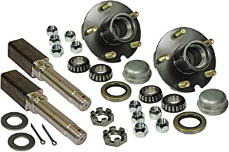

2one8, w/o knowing any more than you posted above ... there are 2 styles/designs of simple hubs and they correspond with the spindle design and weight capacity
if i'm GUESSING the "standard" units you refer to fit 1" spindles which are rated for 2000#/set of 2 = one axle
these smaller units aren't always built with brake flanges if those are important to you and your project
this pic just shows the bare spindle n hub assemblies prior to making up an axe

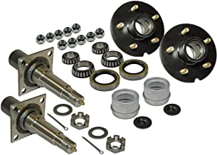

the larger units are mated to heavier/stepped spindles which accommodate heavier bearings all rated for 3500#/set of 2 = one axle
here is a 3500# set and you can see the difference in the shape of the spindle and size of the bearings
the smaller spindle/hub assemblies can accommodate either 4 lug on 4" diameter or 5 lug on 4.5" diameter wheels
the larger spindle/hub assemblies can accommodate either 5 lug or 6 lug diameter wheels
the 4 lug/4" diameter bolt pattern can be found on 8" and 12" trailer wheels
the 5 lug pattern can be found on 8" n 12" n 13" n 14" and 15" trailer wheels
the 6 lug pattern is found on 15" and larger wheels
check the weight designations and if what you are ordering has brake flanges before you order/buy to make sure you end up with what you need/desire for your project
hope this helps
sw

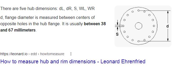

Postby twisted lines » Mon May 02, 2022 12:25 pm
several sizes such as,
Hub size.JPG (35.18 KiB) Viewed 630 times
