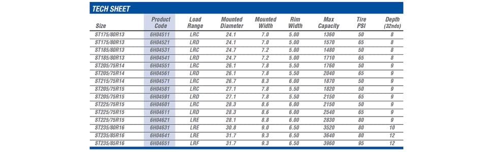

I'm trying to determine what the smallest tire/wheel combo I can get to use as a spare (i'm not all that knowledgable in this area, so need a bit of help).
I'd like to get the smallest tire/wheel spare that will work
The tires currently on the trailer are Goodyear Endurance ST215/75R14 and the wheels are 14 inch X 5 1/2 with 5 on 4 1/2 inch bolt pattern.
1) Can I get away with using a 13 inch wheel (considering the tire would just be used in an emergency situation to get me to a tire center for a replacement)?
2) If anyone has a 14 inch spare, is small width, like 5 inches or less (donut size spare) can you please tell me the make, model, etc.. That would be big help.
