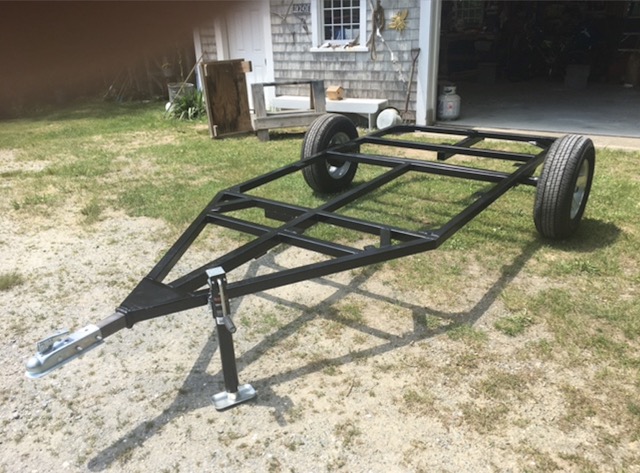

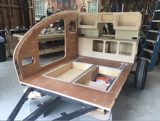

I had welded my frame so the 2 inch members were all on the same plane. The middle tube was larger (2.5 inches) and allowed it be a sleeve for a removable hitch ( I had followed Halfdome Danny's design). This set up allowed for 2 foot wells (if I remember correctly they're about 8 inches deep). I also installed a bed that converts to a couch.
