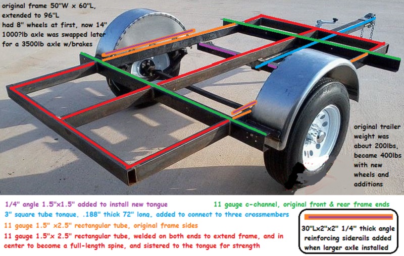

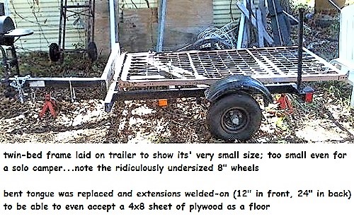

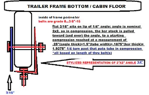

fredo wrote:...5'X10' TD made from 2x2x.125 tubing for main rails and A frame construction with the same tubes for front and back ends and 1 at axle location, the remaining couple cross members I was thinking of 2X1 1/4X3/16 angle LLV for intermediate supports of floor....
* Original trailer frame needed a lot of work to begin with:
small frame to begin with.JPG (127.97 KiB) Viewed 1355 times
* I used 1/4" angle iron in two locations on my frame: first was as a "floor support/tongue tie-in" (making it connect to three crossmembers),

and the second use was as a "frame reinforcement/spring hanger attachment point" when I upgraded my original axle to a larger one.
torquing of hanger assembly (theory).jpg (81.28 KiB) Viewed 1355 times
* The original frame was way undersized, and needed a lot of modifications before campable (and lots later on). It's been rugged and durable for a long time now. More steel and thick plywood made it heavy, but tough.
