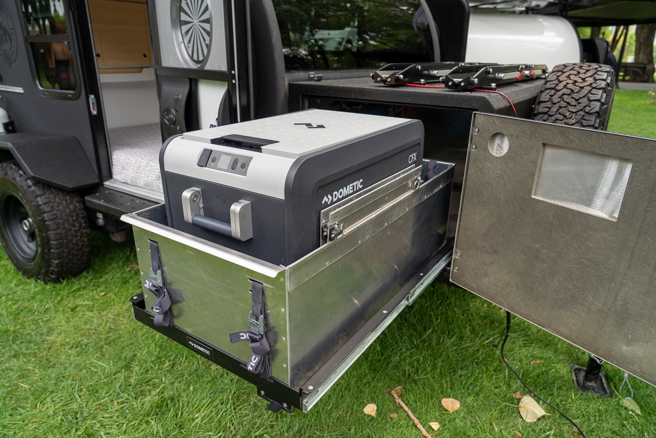

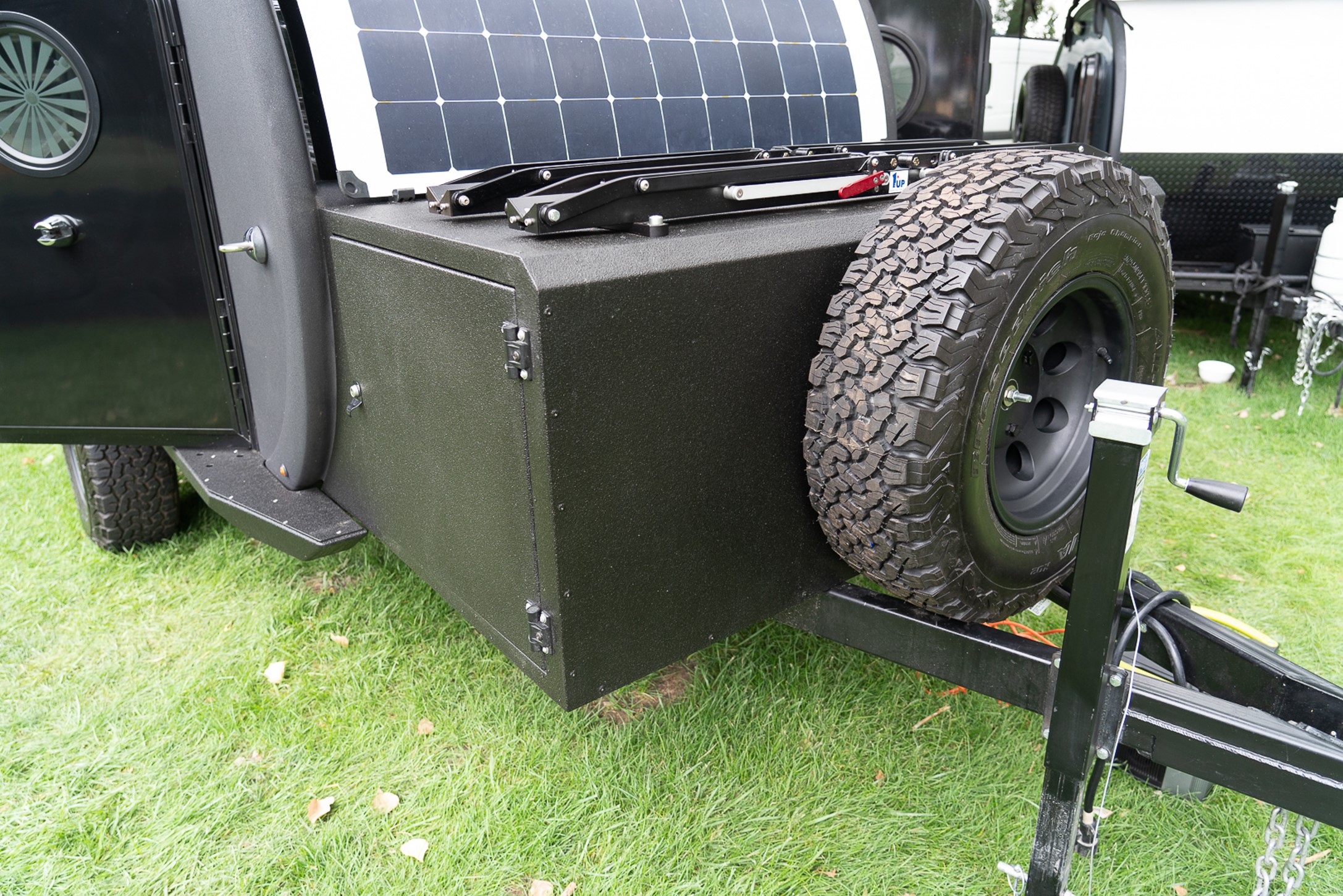

I have started my build and have most of my frame complete. I am in the process of installing my Timbren suspension, brakes and hubs. I have been thinking about a tongue box and I really like the design of the Black Bean tongue box. The box has doors on each side with slide outs for batteries, extra cooler, storage... The reason I really like this design is because I plan to borrow their idea of putting my bike racks on top of my tongue box. I have found the bike racks that they use but I cannot find a tongue box with side entry doors. Does anyone know of a source for these. I think Bean manufactures their own.
Black Bean Tongue Box.jpg (913.62 KiB) Viewed 370 times
Black Bean Tongue Box Slide Out.jpg (655.06 KiB) Viewed 370 times

That's a big TB. Looks like it is accompanied by a very long tongue.
