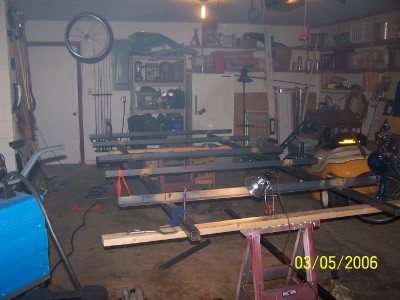

OK, except for my axle which is on order but wont be here for about two weeks and the tongue, which I intend to finish this afternoon, my frame is moving toward being at the painting stage. So, what does experience say? How should I do this? Krylon? Tar? Prime? Don't prime? What is Rust Bullet? I know what I am thinking, but I wanna hear from the guys, and gals, who have done it before, and maybe would do it different next time.

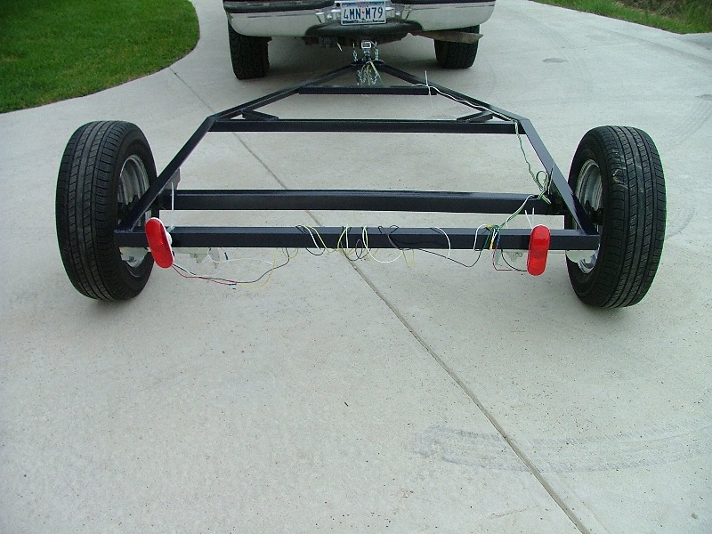

Postby TRAIL-OF-TEARS » Mon Mar 06, 2006 12:10 pm
I second what jack says, Only it might take more than 2 cans of etching primer I used two cans on mine and it is small.
