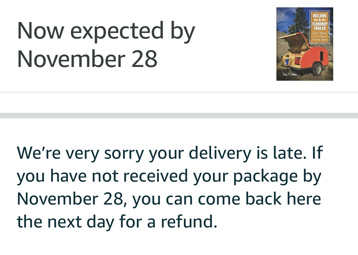

BTW, your Amazon Shipper is killing me, lol.
