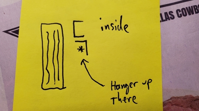

If I go with the C channel do I need to close the c in the area where the axle gets mounted? I'm just going to use a standard spring axle and I'll have the spring hangers welded to a buffer piece of metal to try to spread the stress from the springs. So should I weld that c closed over the entire length of the buffer or would it be better to just put a cross member where each end of the spring mount?

I would weld a piece of 1/4" thick 3" wide angle along the section of C channel where the axle mounts, maybe 24" long or about the length of your springs in full expansion along the bottom side then weld the spring hangers on that. The open side of the C will face inward so place the vertical side of the angle on the inside also so the spring will ride towards the outside. Then 1 cross member in front and behind it.
