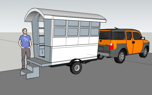

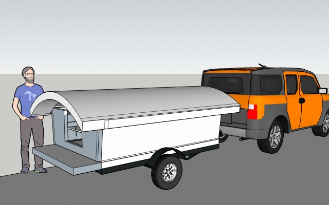

Postby Paintsalot » Sun Jan 22, 2023 2:13 pm
Design before folding:
After folding

The Tractor Supply galvalume...
Can you move the axle back? It's smack in the middle and quite likely will be unstable. :frightened:

No, apparently the axle cannot be moved.
This is the issue:
Single axle trailers should be at about the 40/60% point on the frame.

Postby S. Heisley » Mon Jan 23, 2023 9:02 pm
Just put your main door on the side, in front of the axle, and put your heavier equipment in front, instead of in back. You'll still want to do some weight calculations to be certain that you're at a 60\40 front\back ratio but it would work so you could leave the axle alone. You could also put the door on the front, with a platform on the tongue and still with your heavy equipment/galley up front on either side of the door pathway...another idea to toss around.

Postby Paintsalot » Tue Jan 24, 2023 3:44 pm
S. Heisley wrote:Just put your main door on the side, in front of the axle, and put your heavier equipment in front, instead of in back. You'll still want to do some weight calculations to be certain that you're at a 60\40 front\back ratio but it would work so you could leave the axle alone. You could also put the door on the front, with a platform on the tongue and still with your heavy equipment/galley up front on either side of the door pathway...another idea to toss around.
Hi Sharon,
Thanks for chiming in :-). I'm a bit of a perfectionist.... at some point need to pull trigger on something! The 60/40 thing has me a bit nervous, lol. One of my friends says get a roof tent instead... but that's no fun! No trailer to deal with. But then you have to go up a ladder ten times a day... and no character!
I'm thinking of putting the kitchen part under the benches. I'm imagining benches that fold out into a bed. So I could locate the kitchen gear toward front. The kitchen would be accessed from outside. If I get an a/c unit, it could go toward front. Or maybe just drill new holes and move axle, unless its welded in place. If I don't do the fold down version, I kind of like this style mini- vardo here: [youtube]https://www.youtube.com/watch?v=9j4zcRS4OqQ[/youtube]. Not aerodynamic but looks spacious. I would move doors, etc. Looks like an easy build.
