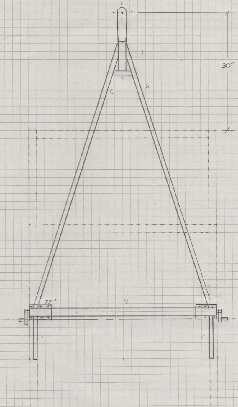

This build (design exercise really, since it will be awhile before I can get to the actual build) will be done in two threads -- one for the teardrop and one for the chassis. The teardrop thread is here: https://www.tnttt.com/viewtopic.php?f=27&t=75601. In order to lower the overall weight of the build, it became apparent that none of the commercially available trailers would work due to the weight. Furthermore, bolt-together trailers will generally be heavier than one that is designed and purpose-built. This chassis will cover what is necessary to size a trailer chassis with a couple of caveats: 1) the teardrop body will be designed as a mostly self-supporting structure 2) the sizing assumes that the trailer is not poorly loaded, or overloaded. I'll discuss the options, and design choices, and explain the fundamentals of how the chassis sizing can be done by anyone who can follow the math and punch the numbers into their calculator. With patience, I don't think it is terribly difficult once it's laid out and I will be happy to answer questions. I will also touch briefly on fatigue (that won't be too deep as I'm not a fatigue specialist).
General trailer layout:
Most trailers are very overbuilt and don't consider the strength brought to the table by the teardrop cabin. Therefore much of the trailer chassis is just along for the ride -- adding weight, but not doing much of anything -- I'm gonna throw that junk away! The walls of the cabin are extremely stiff -- far stiffer even than the steal frame and we're going to take advantage of that. The overall layout will take into account the stiffness of the cabin, which means that the trailer chassis itself can be greatly reduced! You might even call it a reduced chassis or a partial chassis. It's just enough to support the the load introduction from the chassis to the cabin. The cabin will take care of the cabin (we don't need no stinking chassis! (not entirely true, but you get the point!))
The chassis width is 48 inches
Aluminum is 1/3 the weight of steel. I've used steel in airplanes, but when we use it in aerospace -- it's the good stuff. I cant afford the good stuff, so lets compare hobbyist grade aluminum to mild steel:
Steel - mild steel
Yield stress = 47.7 Ksi
Ultimate stress = 58 Ksi
Aluminum 6061-T6
Yield stress = Fcy = 37 Ksi
Ultimate stress = Ftu = 41 Ksi
Aluminum 6061-T4 (T6 post weld and age hardened is approximately T4)
Yield stress = Fcy = 16 Ksi
Ultimate stress = Ftu = 26 Ksi
So, although there are stronger aluminums (more expensive), and stronger steels (more expensive), at the bottom we see that the mild steel is a little stronger than the common 6061-T6 aluminum that the consumer is likely to have access to; however, it is 3 times the weight! A quick check at On-line Metals shows for a 6 ft piece of .065 1x2 steel the price is $36.71, while the same 6061-T6 aluminum in .062 wall is 32.50! So, at the same price, 1/3 the weight and nearly the same strength - let's investigate the aluminum.

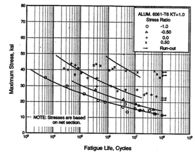

We're talking about aluminum here though, right? How about fatigue?
When aluminum is working hard enough there is damage being done with every load cycle. The higher the stress, the more damage is done with every cycle. If the stress is very high, you might only get a few cycles before failure; however, at low stress there is little or no damage being done. The key to a long fatigue life is to limit the operating stress to one low enough that you aren't doing significant damage when it is repeatedly loaded. For 6061-T6 aluminum the endurance limit is 14000 psi, which assumes: 500,000,000 cycles completely reversed stress (this assumes an stress ratio of -1 i.e. fully reversible). Because I g-loading, OTR or OR, is almost exactly in one direction our load does not fully reverse, and that makes a huge different. We can assume that our load gets applied, and then never goes below zero - that gives us a stress ratio of zero (non-reversing load).
Lets look at the fatigue endurance curves
6061 s-n curve.jpg (88.15 KiB) Viewed 2163 times
The plus symbol is the curve were looking at (stress ratio of zero) and the endurance limit is just a bit above 20 KSI for repeated loading for which stresses below that will result in an infinite life. So, we'll use that as our stress to stay under for Limit loading. This is a bit conservative and we are not realizing limit stress every time the frame is loaded; but, if we set the stress this low at limit load, then we should be way OK for fatigue. Note that this assumes that we haven introduced any holes or welds in a stress critical area.
Let's look at our limit stresses again:
fb OTR = 14.5 Ksi Limit (below 20 Ksi, so it looks like fatigue won't be a problem unless we screw up some design feature!)
fb OR = 24.2 Ksi Limit (this is above 20 KSI, so it doesn't meet the fatigue cut-off for a infinite life)
Therefore, so far, the 1x2x.062 rectangular section should work for the frame (we will do other checks to confirm) in the OTR case, but wouldn't be acceptable for off-roading.
So, what does this tell us? For a OTR design the aluminum .062 wall section should work fine, but for off-road this section wouldn't be recommended. The designer of an off-road version would then have a choice here: 1) use aluminum, but change the wall thickness to .12 in., 2) change the .062 wall aluminum section to 2x2, or 3) use a 1x2 .062 section made from steel, which would carry a smaller weight penalty compared to an aluminum section that now grows to the next size up and doesn't have the same fatigue considerations.

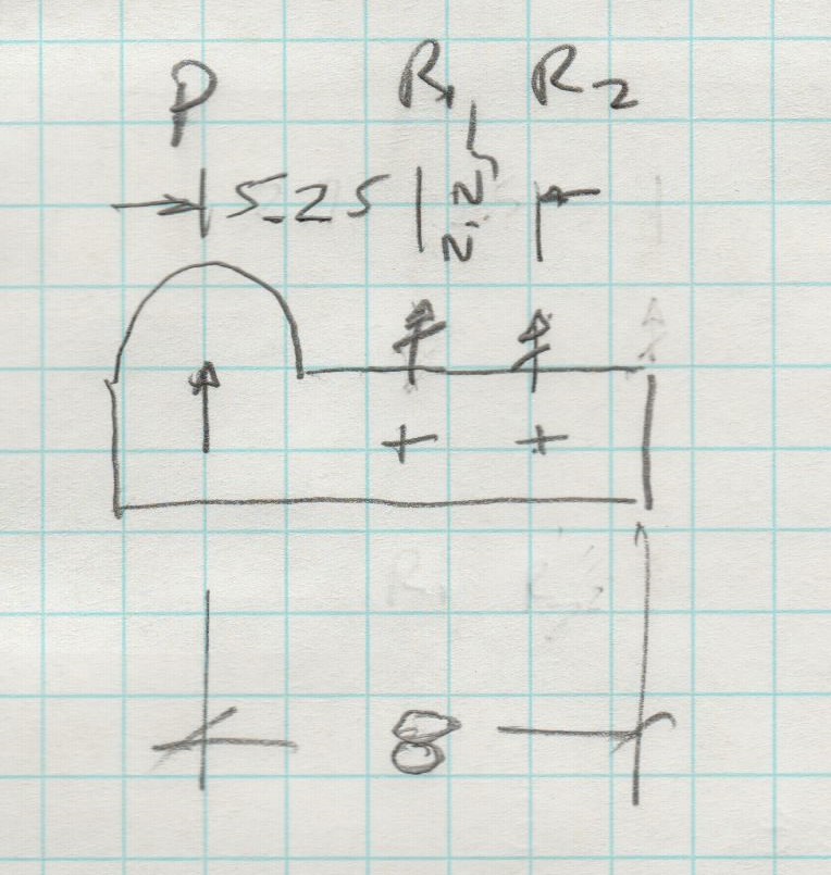

Let's check to see if the attachment of the coupler is OK
sorry for the unsophisticated art...
coupler - small.JPG (146.98 KiB) Viewed 2130 times
The fastener going through the side of the frame section are 3/8 in dia
When we are calculating the reactions on a beam, we typically sum the forces which must equal zero (else it would be flinging in space), and we can sum the moments, which also must be equal to zero (else flinging)
Going back to our ball load, it was 60 lb at 1g
Sum M = 0
Moments that make clockwise are negative, and moments that are CCW positive. For convenience we will sum the moments about R2 (refer to diagram)
P * 7.5 in - R1 * 2.25 in = 0
Solving for R1 (reaction at first bolt) = 5.25*60/2.25 = -200 lb
At limit load (3g) we get -600 lb
Note that the bolt goes all the way through the section and the bolt is in double shear so that each side of the frame section is reacting 1/2 of the load; therefore:
P_bolt_shear = -600 lb / 2 = -300 lb This is a trivial load for a 3/8 inch fastener
We should also check the second bolt (although I already know it will be less critical)
This time we will use summation of forces = 0
60 - 200 + R2 = 0
Solve for R2
R2 = 200 - 60 = 140 lb @1g
Since this bolt load is less than the first bot at R1 is it OK by comparison
Let's check bearing stress in the aluminum
Area_bearing = t * D where t = material thickness and D = bolt diameter
A_br = .062 * .375 = .0232 in^2
f_br_yield = 300 lb / .0232 in^2 = 12.9 Ksi
f_br_ult = P/A_br = 450 lb / .0232 in^2 = 19.4 Ksi
F_br_yield = 56 Ksi
Fbr_ult = 88 Ksi
M.S. br ult = 88 / 19.4 -1 = +high
Fbr_limit = 88 Ksi
M.S. br linit = 56 / 12.9 -1 = +high
Note these fasteners go through the frame section near the middle (close to the centroid) where the stress is very low so that it doesn't affect the margin we already calculated for the frame section
Coupler attachment is OK

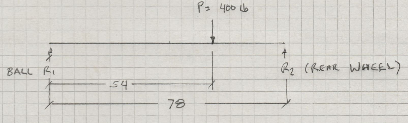

That pretty much covers the loads expected whilst going down the road. There is one other condition that I considered and that what about when both people are in the cabin? The critical condition is likely when they are both entering into the cabin at the door, and let's say they plop them selves down in the doorways simultaneously.
Assumptions:
2- people @ 200 lb each
1g plus 1.5 dynamic magnification factor
people_loads - reduced.JPG (91.39 KiB) Viewed 2093 times
We need to calculate the load on the ball
The 2 reaction points are at the ball and at the wheels (see figure above)
Summing the moments as we did before about point R2
-R1 * 78 in + 400 lb * (78 in - 54 in) = 0
Solve for R1 = 400*24/78 = 123 lb
plus we have already the static load from the trailer itself (remember that 60 lb load on the ball?)
P_ball_total = 123 lb + 60 lb = 183 lb (this is at 1 g)

Yes, I already addressed that. It's very similar to the Pico frame, but there no numbers or analysis to support the sizing so this is about figuring our how to size the frame (any frame really). The principles would apply to any frame -- not just an A-frame. I chose the A-frame because I believe that to be the lightest weight configuration and I need a very light teardrop.

Just wondering if instead of an A frame it was a U frame. Possibly supporting two to three feet of the front of the cabin.
More complicated obviously requiring some bending.

TimC wrote:Just wondering if instead of an A frame it was a U frame. Possibly supporting two to three feet of the front of the cabin.
U's, not being straight create additional torsional moments when loaded. It might well work, but there is a cross member in the floor, shown on the cabin thread (as opposed to the frame thread). And I think you are right about the forming challenges. I think, in the end, the cabin is still supported at 3 points -- the ball, and each of the 2 wheels. If the cabin is self-supporting and has a good attachment to the frame, I think it should work out OK. The original layout, by Andrew for the Pico also had the A-frame configuration, and I incidentally just spotted a teardrop that is currently being manufactured with an A-frame trailer. I haven't show the weight calculations, but right now at .062 wall the frame weight (not including suspension or coupler is just over 11 lb. If you go up to .125 in wall thickness it's still only 17.4 lb! With the torsion 1/2 axles this should be a very light trailer!
