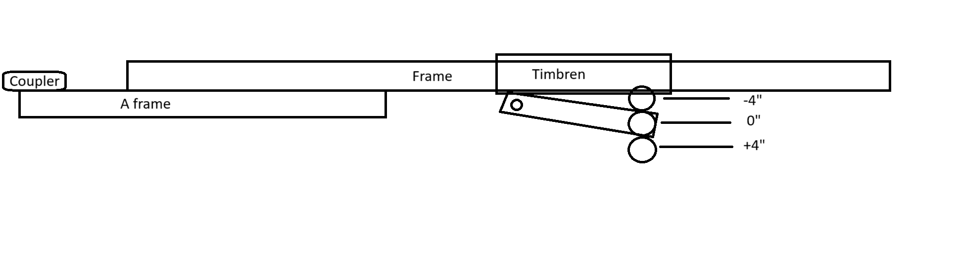

I think you've got it right, but just want to make sure with a visual.
Is this what you have in mind for the A-frame and coupler?
Edit: Oof. Sorry. Didn't realize that sketch was so wide.
Feel free to edit, if anyone wants to doodle on it.
Two (and a half?) things to keep in mind:
-If you're measuring to the center of the hitch ball, you should also measure to the center of the coupler.
-Tires will probably squat about 3/4", possibly a little less, if aired up to a pressure appropriate for the trailer's final weight and payload. While we do use full radius/diameter for many tire calculations, tire squat should be considered, if not included, for static height calculations.

Postby italianub » Tue Jan 02, 2024 11:05 pm
Yessir!
Squigie wrote: -If you're measuring to the center of the hitch ball, you should also measure to the center of the coupler.
here's the photo i took!
Squigie wrote: -Tires will probably squat about 3/4", possibly a little less, if aired up to a pressure appropriate for the trailer's final weight and payload. While we do use full radius/diameter for many tire calculations, tire squat should be considered, if not included, for static height calculations.
-Have you considered what these various heights would do to fender height and fender length at floor height? Interference with other plans, or getting too close to the door(s), should be checked out. (But everyone's plans are different and it may be no-factor in your case.)
The fenders will be custom like the rest of the trailer, so I am not worried at all about the fenders. I am mostly just concerned with the height of the trailer vs height of my hitch (I know I can get hitches that are below/above the current ball, but I also don't want the trailer to be too tall)
