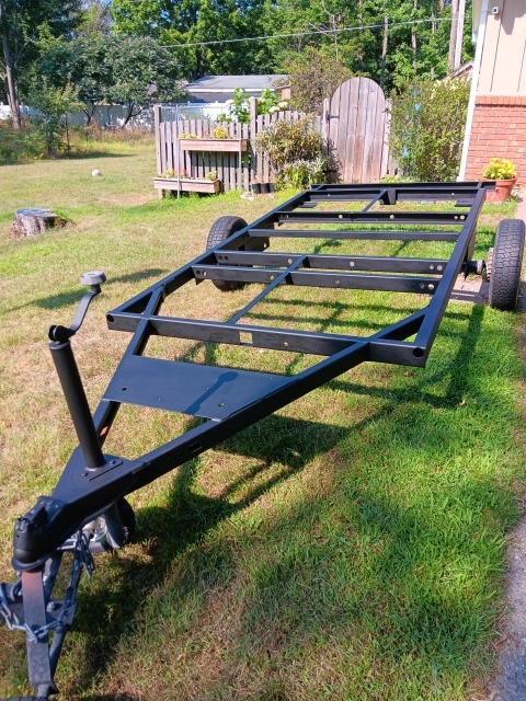

That's a bummer. I certainly didn't pay $850 for my Sterling 4x8; NT's current price. I did mention in my last post that I would not purchase this model again and I'm pretty much going to stick to that thought even though the Ironton 5x8 is no longer available through NT. I'll stick to old pop-up frames such as this one. A former Flagstaff by Forest River...
I've been lucky in my pop-up finds so far usually paying nothing to a couple hundred dollars up front then selling appliances and such to gain back most or all of that investment. When I cut, grind, wire brush and rust treat these trailers they come out very nice. If you think about the fact that most of these frames have just a few thousand miles on them and are rarely used in the salty road winters. They almost always have the original tires; the Flagstaff being a 2002 model. I get a chuckle when the owner selling says "Look at the tread. There's plenty of life left!" 23 year old tires... what could happen? I always carry two spares with me when I pick them up.
I have about $50 in supplies to refinish the one pictured. So other than I bought 14" rims for $25 and will put some new tires on those at just over $100. A LOT of man hours on the tear down though. Included in that return on investment is $30 tipping fee at the dump for all the non-recyclable materials. The metal was donated to the local Habitat ReStore. Currently I'm $21.45 positive and I have a nice trailer to build on or sell. It's currently post on FB Marketplace for $675 (can you tell I don't really want to sell it?).
Shhh!, don't tell anyone about recycling pop-ups! ;) I don't want my hobby of tearing down pop-ups to become harder to find or more expensive... :lol:
