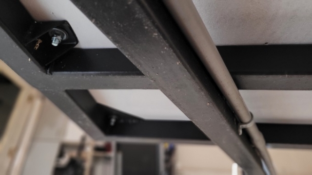

Postby Onajourney » Mon Feb 05, 2024 9:28 am
I ran all wiring from hitch to rear of trailer and up through floor in one 1/2" pvc conduit. strapped with self tapping screws.

Re: trailer wire "clips" for square tubing
