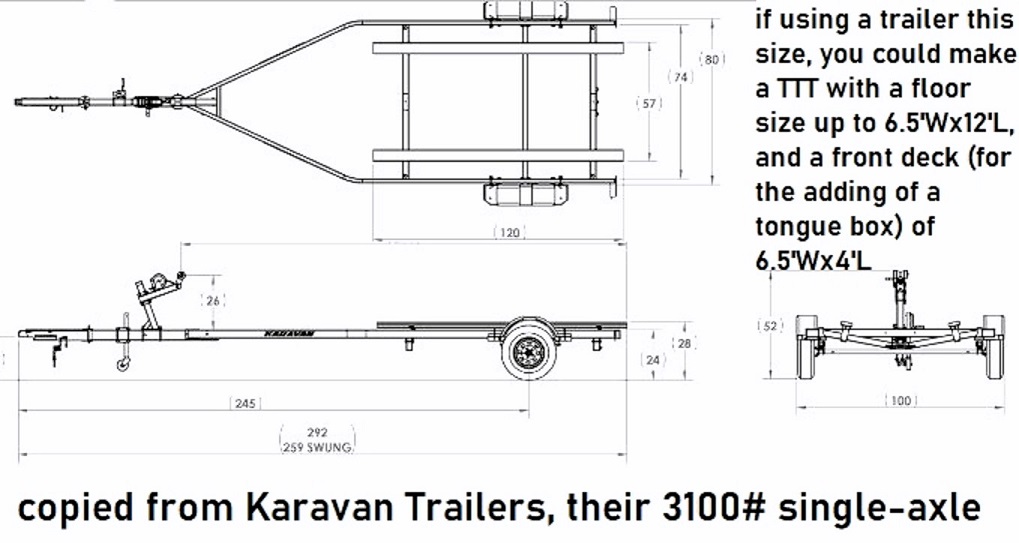

on Jan.09, 2024, from another thread:
ScottM wrote:I'm in the planning stages right now for a larger trailer. The dimensions are still TDB but 14-16ft long by 7-8 feet wide.
Is the boat trailer frame the same one you had earlier planned to use, or has your design plan changed? Most boat trailers (single-axle) are smaller, but are you using a double-axle boat trailer?
I found some drawings on the Karavan Trailers website, to use as a visual sample of a larger, single-axle boat trailer (3100 lbs). With one like this, you could easily build a large cabin atop the existing framerails, using 3/4" plywood spanning the rails, and with dimensional lumber added to the slides underneath (to bring their height up to the level of the framerails. if different, as support for the plywood flooring}. Simple Tek screws could be used to screw-down the plywood to the steel frame (I used 38 to screw my floor down to the perimeter of the frame, plus PL adhesive in between), with no need to weld-in angle iron supports.

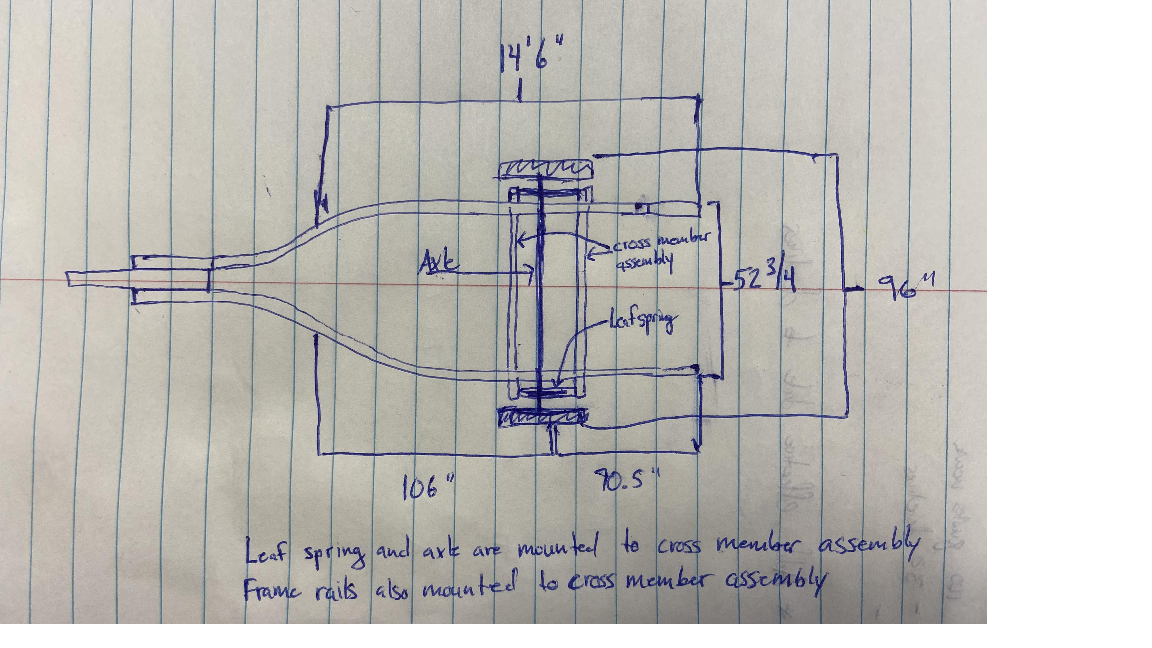

Thanks for taking the time for such a detailed response. Yes, same trailer referred too earlier. It is a single axle but a little longer than what you've shown here. Here is a crude drawing of what I am working with. My trailer is kind of odd from what I've seen. There is a cross member assembly in which the axle and leaf spring are attached. The frame rails are also attached to this cross member. My plan was to use some two inch foam sandwiched between 2 1/2" thick plywood. There would be some minimal wood framing in between the plywood as well with a couple extra supports in the middle where the "walk way" is in the center of the trailer. Ill take a look at the sagulator and see if i can get away without the angle cross members.
