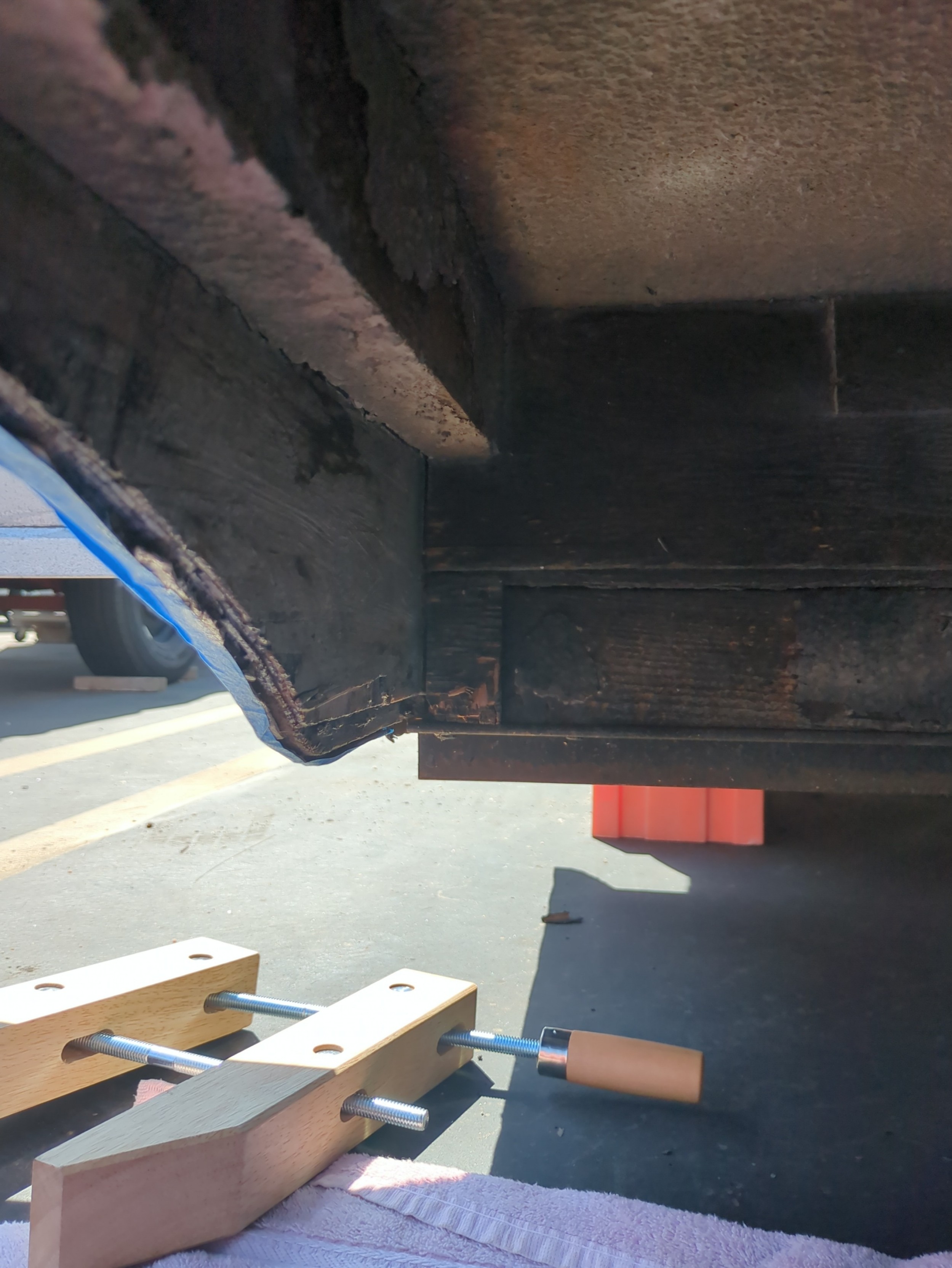

So I've had my little 14.5' vintage canned ham for a while now, things are mostly good, but it's old. I recently notice some exposed plywood near the front that is delaminating, unofrtunately.
2025-03-09_16-01-07 smaller.jpg (884.18 KiB) Viewed 647 times
My thought is to do a 2 step process. First, use some spray (Super77?) or construction adhesive and some deep throat clamps (using other pieces of wood to protect surfaces) to mostly get it back holding together. Something that's outdoor/water exposure rated. Let it sit for a couple of hours.
Second, doing some light sanding to clean up the surface slightly, then using some construction adhesive and new 1/4" - 1/2" thick wood custom cut to fit, and the clamps again, to add some fresh wood to provide fresh support. After a couple of hours, removing the clamps and using pilot holes and counter sinking to put a number of screws in to help keep things together. Next I'll clean off the area around some with a bit of sanding and then some SEM Solve https://semproducts.com/product/sem-solve/38373 to clean off any gunk, and then use SEM 40463 https://semproducts.com/product/low-voc-undercoating asphalt based undercoating, probably 2 or 3 coats, to build up a protective coating.
Reason I'm looking at the SEM products is they come in spray cans. I don't have a air compressor nor know anyone I can borrow, don't have any place to store one, and I really don't need to do _that_ much of a surface area where it'd make sense.
For the 2nd part I'll be doing a bunch of taping and plastic bags and such to prevent overspraying or dripping on the ground. Also going to be using full face shield & VOC respirator, I'm sure even in the first step there will be nasty stuff coming off the sanding. Even more so the 2nd step.
Thoughts? Better product(s) to use? Am I going about this completely wrong?

Hm, interesting idea. But I do want to get the end back to flat(ish) for the one that's really curling away, so I'm going to need to do some kind of clamping as well. Also...how to get it to soak in? This is on the bottom, so it's going to run downwards towards the ground pretty badly.
Maybe something thicker that I can push/squeeze up the gap, and then clamp and hold it, but I don't think it'll soak in the amount that would make it worth while. If I could turn the entire trailer upside down to keep the epoxy where it should be. I think the coating it with the asphalt based coating will be sufficient.

I was basically going to do that, although I don't have room to completely go across, because of the way you see it.
I actually decided to get some DAP Weldwood Landau Top & Trim spray. Seems to be extremely strong, and I can spray it up into the delaminated area to be sure to get it all the way up into the edges, and designed for laminating things together with high temp & moisture resistance.
https://www.dap.com/products-projects/p ... gh-streng/
Then I'll put some wood across the area, with the bottom section with painters tape in case it a bit squeeze out and gets on it or comes through the thinner/broken up bits of the wood. I'm thinking Baltic Birch as the sister/covering wood, 1/8-1/4" thick. Just enough to provide additional strength and support without significantly adding bulk or weight.

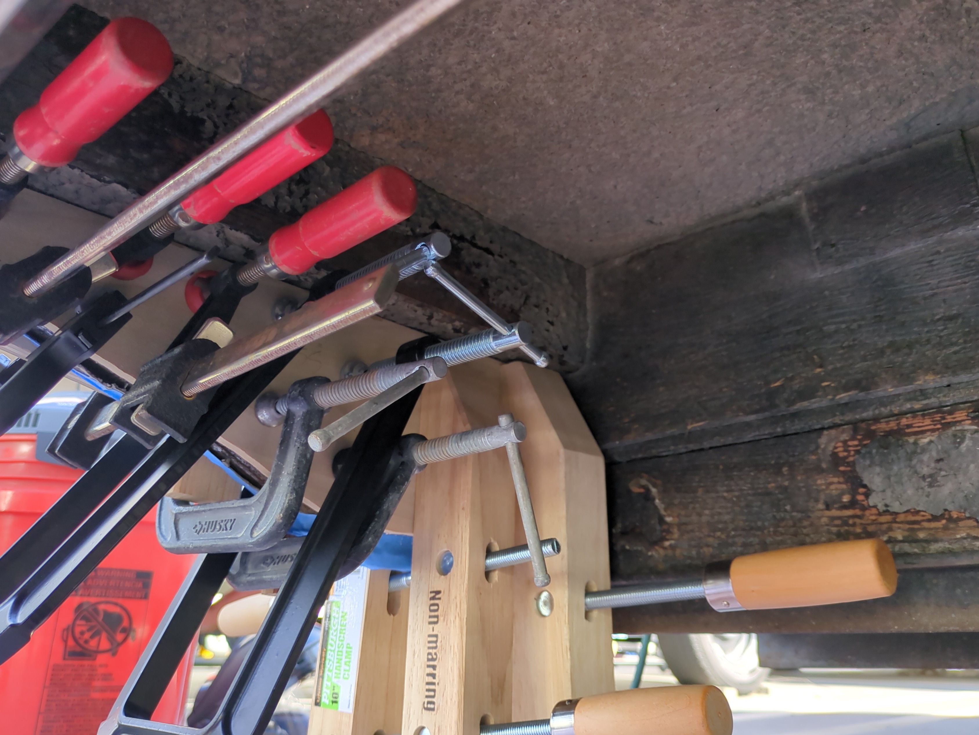

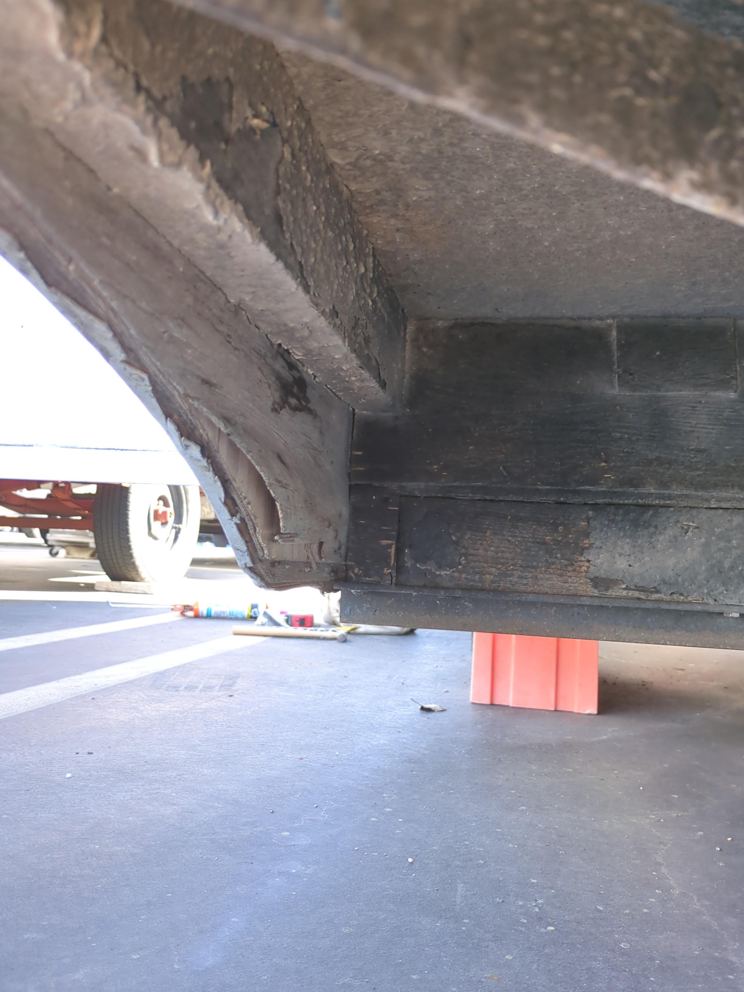

Ok, an update. So far things are going well. Also chipped off some flaky or coming loose undercoating, so have a fair bit of area to also coat/re-coat with the undercoating besides the side.
Ended up going with 1/4" thick poplar, mostly going to be to help hold things together and provide an outer surface that's stiffer/thicker, should the undercoating start coming off entirely again.
Here's after I sprayed and clamped the delaminated plywood (original picture above).
And here's with the poplar clamped up with more of the spray glue. I'm waiting >24hr (can says 24 hrs for full cure), and then pilot hole and stainless steal pan head screw to provide additional hold through.
