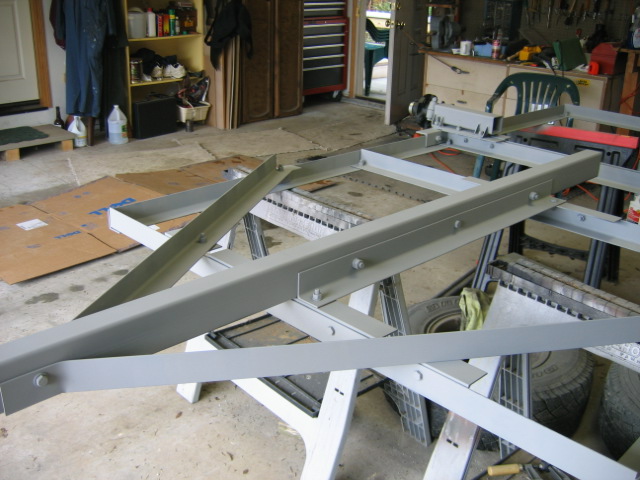

Postby angib » Wed Mar 22, 2006 7:24 am
1-1/2"x1-1/2"x3/16" angle is 20% less strong than 2"x2"x1/8" angle and 40% less stiff.
For most of the frame, like under the floor, I can't see that being a problem - assuming you're not intending to use this material for the tongue. The only difficulties would be the two cross-members that the tongue bolts to, but if you use an A-frame tongue or a Y-braced tongue like in the photo above, that's also no problem.
Andrew

Postby greg55 » Sat Mar 25, 2006 5:23 pm
Thanks for the replys.Thats a nice frame Andrew.Thats what I had in mind.I figure I would only save 37 lbs using 1.5" angle instead of 2".Being a bit more stronger would be worth the extra weight. I would use 2"x3" tubing for the tounge.
