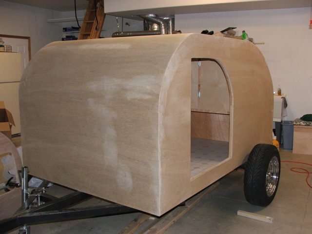

Postby bledsoe3 » Wed Mar 29, 2006 1:16 am
I built my trailer 5' wide and put the sides over the frame.
As Mike said, I used luan so the extra width was not a problem.
