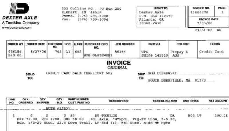

I received my dexter axles last Friday and the Invoice the other day. Thought I'd share it with you in case anyone is going in thew same direction. As I stated in a previous thread for my build I'm using '35 Ford wire wheels that have a 5 on 5 1/2" bolt pattern. This is not available on a standard order axle from Dexter. What they did for me was put #10 spindles and hubs onto a #9 (1200#) axle.
Croping and scaling the image left if less than ideal. So here are the specs:
#9 Torflex rated at 1200#
Hubface to Hubface - 71"
Trailer frame width - 58"
Idler Hubs w/EZ lube
5 on 5-1/2 Bolt Pattern with 1/2-20 Studs
22.5 Degree Down Starting Angle
Wheel Nuts & Side Mount Hangers
