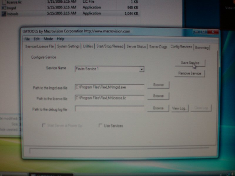

To run Inventor you need to initialize FlexLM and leave it running in the background while you start Inventor.

Postby mikeschn » Sun Feb 18, 2007 4:14 pm
FlexLM has to be setup after you install Inventor. It should be on one of the CD's that came with Inventor.
When you find it, and run it, it'll look something like this...
