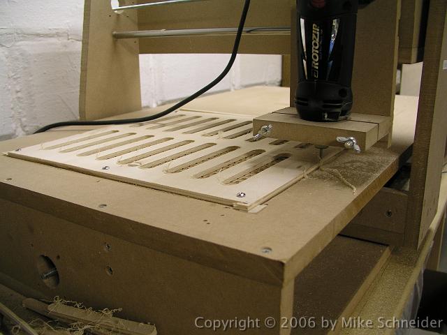

I haven't used my CNC machine much. I've only ever done 2 1/2D machining. That's why my goal is to learn 3D CNC.
Here's the AC cover I did for the Lil Diner...
I also plan on building a new CNC router someday, and dismantling the old one. It has WAY too much flex in it. I will probably use angle iron for rails, similar to the 4x4 that Joecnc2006 built.
