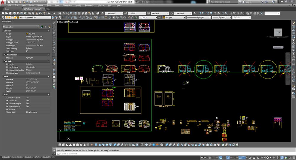

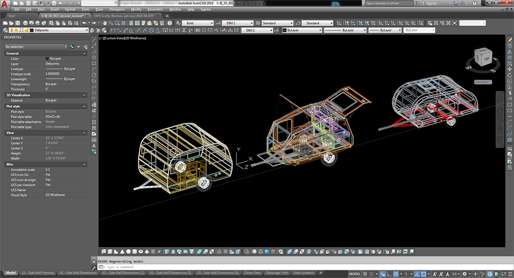

All my teardrops (and a Scotty) are designed and documented first in Autocad. Starting in 2D plans and elevations, and once those are figured out, I build it in 3D, still in AutoCAD.
If I want it in Revit, I export it from CAD and then import it into Revit. As much as I LOVE Revit, its not a design tool for anything other than buildings. Because of the way things are constrained and the way the tools work, it does have its limits and difficulties.
Can a camper be designed in Revit? Absolutely, but you would not want to design it inside a Revit project using walls and floors (as you would a building). If you really wanted to build the camper in Revit, it would be much easier to design it as a 'family' component, and then insert it into the project. Things such as wheels/tires and doors would also be designed as their own 'families' and then inserted into the main camper family, which would then be inserted into a project.
The tools in the family editors work very similar to the solids editing tools in AutoCAD. Theres still a learning curve though, especially for those who have used AutoCAD all their life. Revit, although an Autodesk product, is very different from AutoCAD and some of those CAD habits are hard to break.
A long story short, if you want a camper in Revit, but you're comfortable in CAD, build it thre first and then import into Revit. Modeling in Revit isn't going to get you any further ahead in the end. If you assign materials to the 3D solids in CAD, they can be controlled in Revit.
