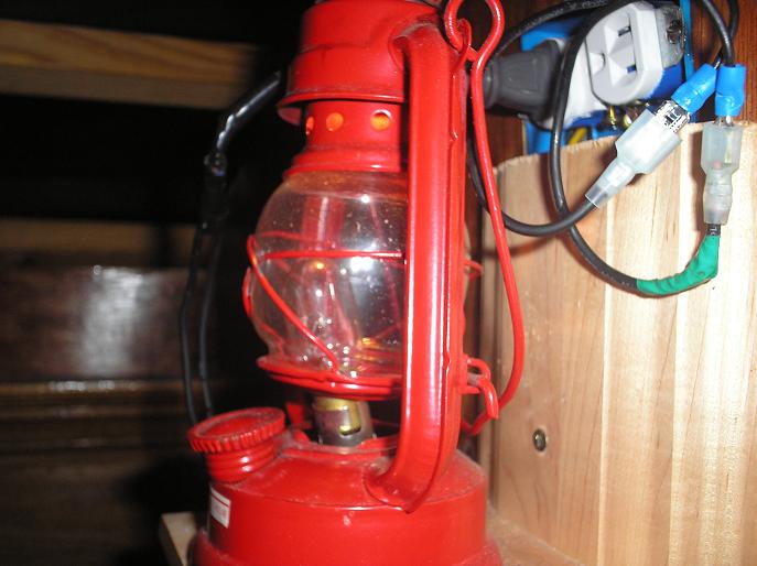

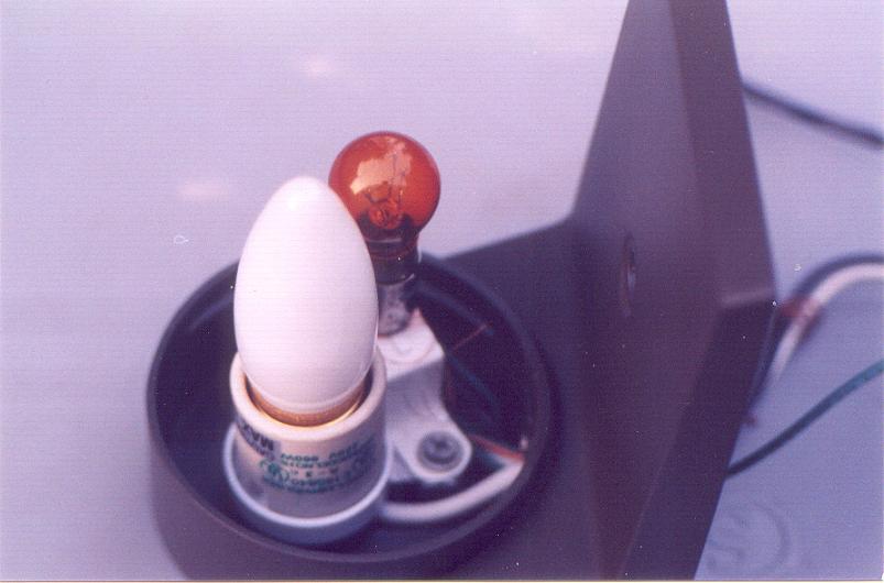

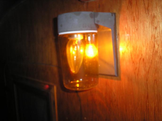

I used 12-3 extention cord for the AC and a 2 wire 14 gage for the DC that I stripped form a tossed out vacuum sweeper.
They both are in the same switch box controlling the same lamp. These switches control both Ac and DC bulbs mounted in the same fixture,
Here are the switch boxes I used a flip toggle rated for 120V AC and a rotary switch for the DC so even in the dark you can feel which one you have. The lower switchs control the little interior lanterns and the higher ones closer to the door controls the "porch" light.
