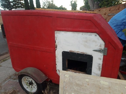

Postby saywhatthat » Sat Nov 27, 2021 6:55 pm
$30.00 a door blank with willy window . so easy to build if you can slobber on yourself you got it beat. No T or J molding to fight can not rot glass over right foam
Il suffit de le faire
viewtopic.php?f=50&t=73945
