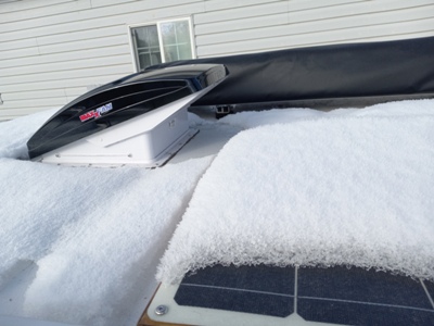

Postby twisted lines » Thu Dec 15, 2022 5:23 pm
Checked mine from this far today!
Cracked like always; should dab something on the screw's this summer :roll:
Racking up; And Rapin foam

Postby sweetnsaurer » Thu Dec 15, 2022 8:28 pm
Really nice looking! Thanks for sharing, I like the idea of having it cracked open for ventilation w/o worry of rain getting in.
