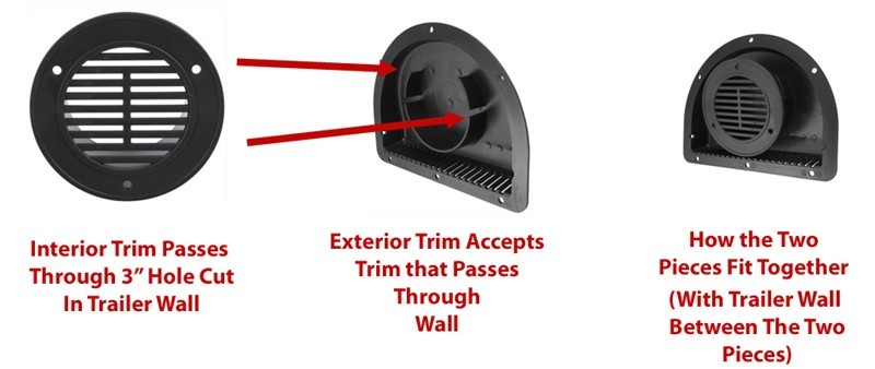

I installed 2 of these on my last build. They are passive vents but helped with ventilation

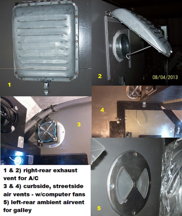

  • I use a different sort of air vents, three as designed, and one gutted, to use as a matching look-alike for the other three, while serving as a rain-cover for my A/C exhaust ducting outlet. Actually, these vents were designed as rooftop vents for enclosed trailers, but I figured that they would be as rain-proof (or more) when mounted on the sides of my TTT. I use the #9139 vent, ordered from E-trailer; I originally chose these because they were rain-proof, had an industrial-look galvanized finish, and were different than the usual vents you see out there (plus, I saw several in use on trucks at my loading dock, at work).
    9139 vent @ E-trailer.JPG (39.65 KiB) Viewed 18629 times
    once only sold galvanized, they now look painted silver
  • I use two of the vents for cabin ventilation, with screen material attached, to keep out insects. I leave them open in my garage, to prevent mustiness and mildew, and the louvered design keeps dust out. I can also leave them open, when traveling on the road, and no water or dust seems to get in, either. I also have a couple of high-flow computer case fans attached on a bracket so I can swing them in front of the vents, or away, as needed (the fans are also reversible). I use a similarly-screened one in the rear galley, for ventilation, but without an attached fan. My fourth vent has been gutted, used as a look-alike cover for my A/C exhaust duct, though I tried to vent thru it, but it restricted the airflow. However, the three used for just regular venting work great, as-is.
    usage of rain-proof vents.jpg (203.96 KiB) Viewed 18629 times
    great vents, for all purposes

Used the same 3" vents as Greygoose, down at the footwell of the bunk, with imbedded 2 1/2 " computer fans to be used as necessary. Natural draw in cooler weather with a cracked roof vent, powered flow in warmer temps. Gotta keep those tootsies comfy!...........jd

greygoos wrote:I installed 2 of these on my last build. They are passive vents but helped with ventilation
grey or jd, do you have a link where you purchased these vents..?

Postby greygoos » Fri Aug 17, 2018 3:00 pm
https://www.ebay.com/itm/TRAILER-SIDE-W ... 3031!US!-1
I also placed screening inside the vents to keep out the bugs
