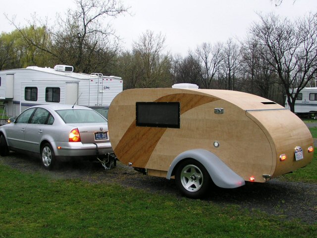

We picked up the Lil Diner from NY this weekend, and had our first campout.... it was kinda cold, and even more wet... but we were cozy and warm inside the Lil Diner, even without appliances.
The morning after it stopped raining just long enough to get from the teardrop to the car, and then it started right back up.
I didn't get much in the way of photos yet, but here's one for you...
Postby beverlyt » Mon Apr 25, 2005 6:23 pm
:) Sure don't look like the rest of em in that campground!

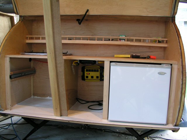

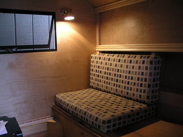

Postby mikeschn » Fri Aug 12, 2005 6:45 pm
Well, we spent the whole day working on the Lil Diner.
We raised the rear bench so that it was the same height as the front bench.
Then we did all the 12 volt electrical. Our power supply and fuse block haven't arrived yet, so we are running off battery, without fuses. Yikes! :shock:
Next design challenge: plumbing the propane over to the stove and forced air furnace...
Here's a couple photos...
The first, you can see the lights we bought at sailor sams. We really like these lights, they are so bright. Xenon!
In this photo you can see how we bring in the electric thru the outside wall, (look for the orange wire), thru another wall where it plugs into a gfci unit, and then into the yellow utility extension cord box. From this box we power the fridge, the ac, and the power supply when we get it. I'll have photos of the fuseblock wiring perhaps next weekend.

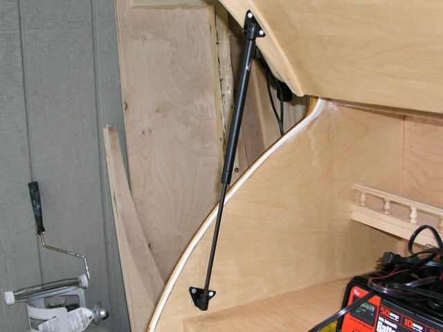

Postby mikeschn » Sun Aug 14, 2005 6:47 pm
Hey Steve,
We installed the gas shocks in the Lil Diner today. They are a little longer than originally planned. They are 90# shocks, and they are 19 1/2" long, open.
Handles the weight of the hatch wonderfully...
Postby Chris C » Sun Aug 14, 2005 8:05 pm
Mike, I'm a little surprised to see that big trailer behind that little Volkswagen. Is that a Passat? What does your Lil Diner weigh in at?
Chris :D
Chris C
Posts: 3302
Location: Norman, Oklahoma
Postby mikeschn » Sun Aug 14, 2005 11:31 pm
Yep, that's a Passat TDI.
And I haven't weighed the Lil Diner yet, but it's light. the Passat drives like it's not even there.
