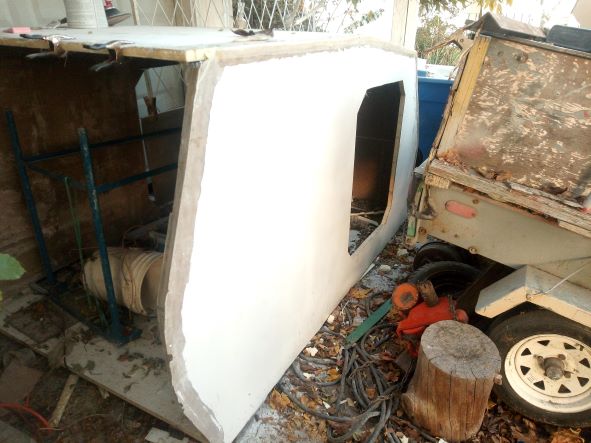

Countless times I have said you are building an aircraft not a tank.
164418164497
Re: Wall / sides construction
Postby 1130451B » Fri Feb 25, 2022 10:15 am
Shadow Catcher wrote:Countless times I have said you are building an aircraft not a tank.
164418164497
Is that the layering layup you used in your build?
