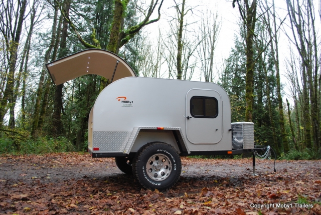

Anyone know what the front and rear radius of the Moby1 XTR or XC might be, either by looking at the pics or having communicated with the staff there?
http://moby1trailers.com/moby1-xtr/

OK, I think I want a tighter radius in the back. Like this...any idea how to guess that radius from the pic?

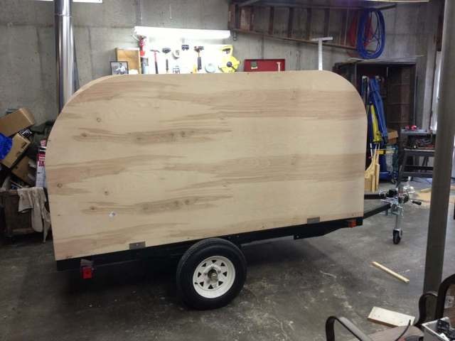

I actually played around with making a few radius tools, drew a few curves and happened to like one. So I cut the sides and bolted them up. Im good. Thanks everyone!

I just finished cutting my profiles last night. I went with an 18"radius in the front, and a 36" radius that is 12" up from the bottom for the rear.
