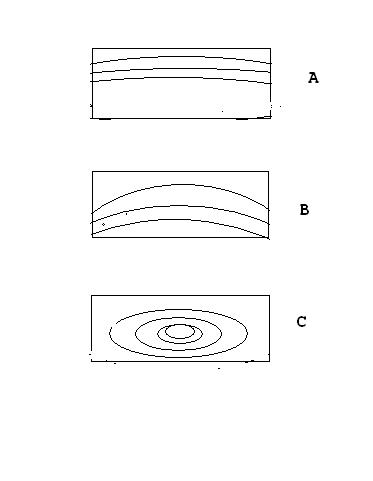

I had to look long and hard for this image.
If you are standing looking at the end grain try and select the grain as shown in "A"
The "B" selection will most likely cup in the direction of the grain
And "C" while more stable than "B" may have a greater tendency to twist
