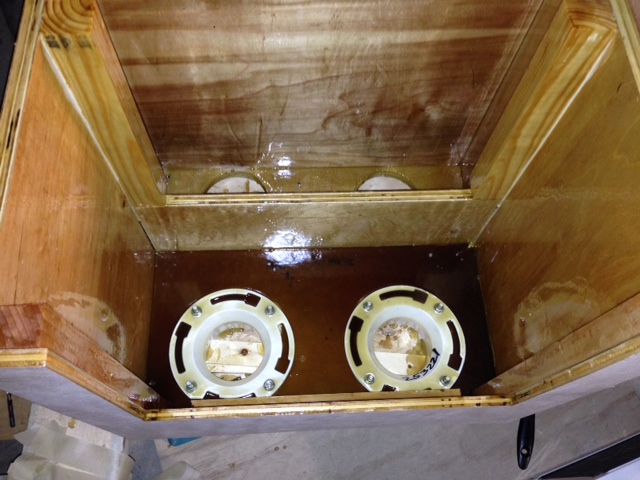

This was my solution. I wanted a removable box but not something I had to set up. This slides in and out and breathes through the bottom of the trailer. I will absolutely not go camping in Texas again without an AC. The Ac box was one of the first things I designed and built. It has two chambers inside the box, intake and exhaust. The whole inside is lined with fiberglass and resin so it is waterproof. I didn't want to have it sticking out of the trailer at all. I wanted it hidden and it is crazy quite when you are outside the trailer and a quiet whoosh inside.

Your idea is almost exactly what I did. This is the box the AC5000Btu slides into. This is a top down view. There is a divider in the middle. ACs are designed to bring in outisde air through one set of grills and exaust hot air through another set. You just build your box to divide these two vents and have seperate holes for the air to come in and go out of. Wateproofing is very important because ACs produce so much water through condensation. Once the Ac is running it seems to evaporate the water into the hot exhaust and not drip out.

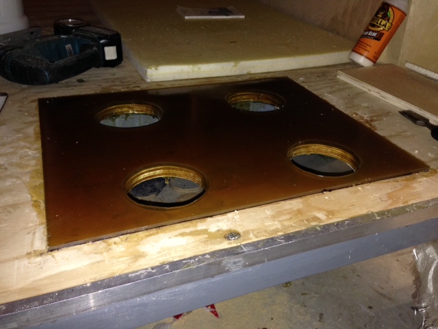

This is the floor of the trailer in the back galley where it sits. I built this by making a frame on the floor and pouring in resin to cure and make a waterproof platform. I used fiberglass cloth in the holes and under the trailer first. The bottom of my trailer is coated in resin. The box slides in the back and sits on a neoprene gasket to take out the vibration and seal the intake and exhaust ports.
