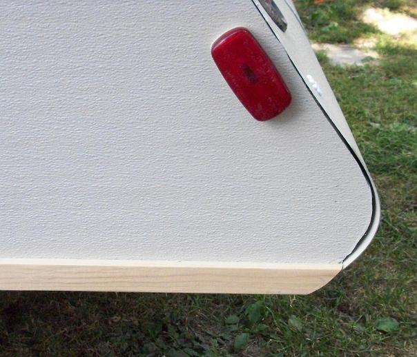

I used the Sequentia Panel used as bathroom liner walls. Perhaps this is a somewhat different composition than the filon but it would heat form with a high output heat gun. These panels have a joining strip that make the transition from sheet to sheet and with some good 100% silicone the joint would be water tight. I had a very tight 4" return on Rip Van Winkle my little 4x7 teardropImage
I simply heated the material and hand formed it. You can feel it relax and then form it. You have to wait and feel this or it will crack but I had no problem tightly curving a 4' section around the tight return. I have done two trailers with this material and truly love it. It is forgiving and carefree as well as being scratch and impact resistant.
